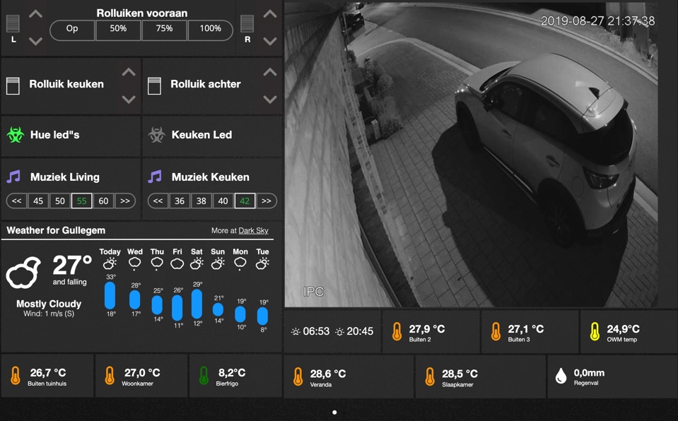

Mine so far, first screen almost completed.
Played with the temperature icons, icon and icon color changing depending temp. value.

Stepdes wrote: Tuesday 27 August 2019 21:48 Mine so far, first screen almost completed.
Nice
mm that screen [ rolluiken] option, please share..
And your camera option.. [ cannot get my camera to work ]

Looks nice.

Derik wrote: Tuesday 27 August 2019 21:53]
Nice
You need to count the seconds it takes to close the screens to 50% and 75% ans put this in some blocky scripts, then create a selector switch in domoticz and link this to the blocky scripts
What camera do you have? you know the url to the camera stream? if not, check Ispyconnect website fot your camera.

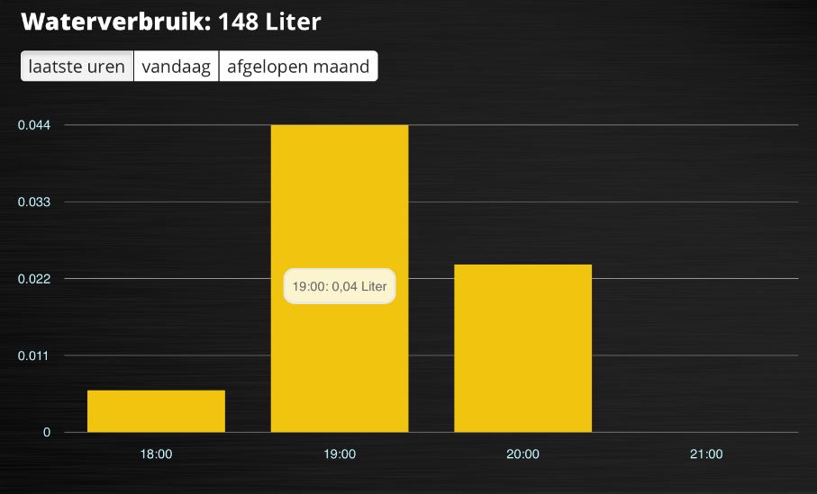

My water usage graph in dashticz does not show liters but m3. In domoticz the values are reported in liters (x1000). Is there a possibility to adjust the graph so it shows liters instead of m3?

i was also wondering if it is already possible to adjust the y-axes values in the graphs?

madradrakie wrote: Wednesday 11 September 2019 21:36 My water usage graph in dashticz does not show liters but m3. In domoticz the values are reported in liters (x1000). Is there a possibility to adjust the graph so it shows liters instead of m3?
With the new graph module, a first version is available via the graphjs branch, you can create a custom graph.
See https://www.domoticz.com/forum/viewtopi ... 67&t=29145
I've posted an answer in that topic:
https://www.domoticz.com/forum/viewtopi ... 20#p223842

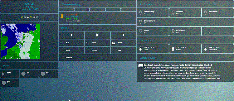

I installed Dashticz on my Synology and everythings works except OWM.
I put the API in Dashticz, but no forecast. Can some one help me.

leonhannink wrote: Friday 01 November 2019 12:30 Hello,
config['owm_city'] looks a bit weird:
config['owm_city'] = '\'xxxxx';
but that might be copy/paste issue. There should be no slash in the name.
Can you open the developer window in chrome (press F12), and check the result of the network request to openweathermap?
(you can find it in the network tab)

Thanks, it works
