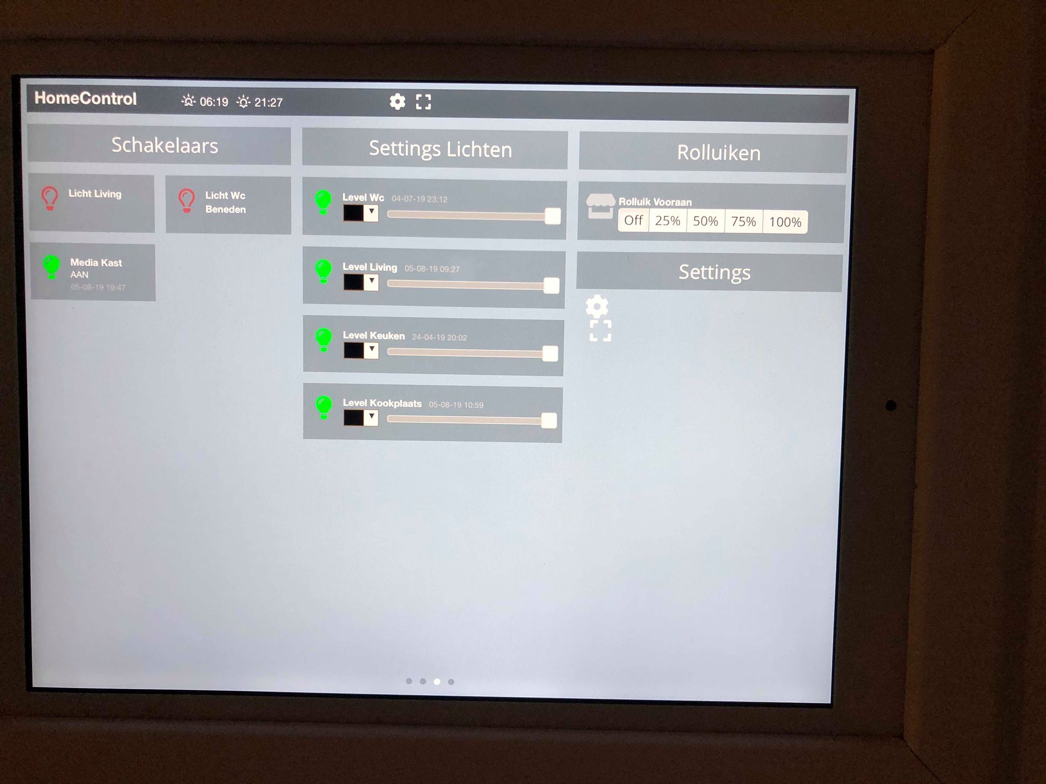

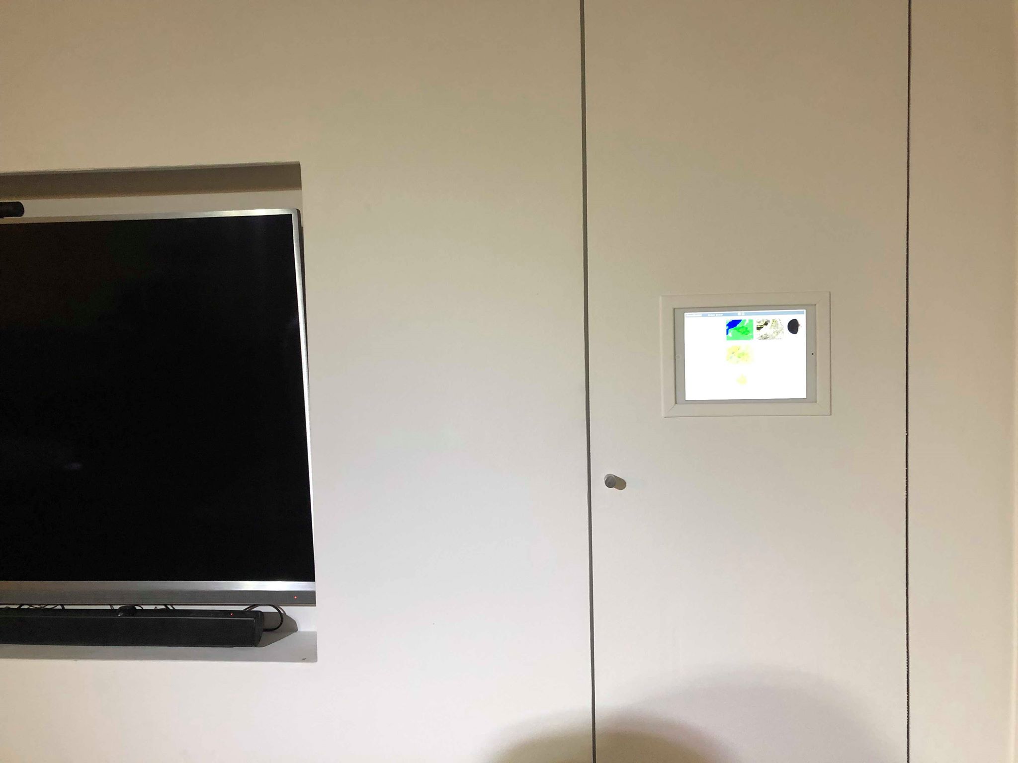

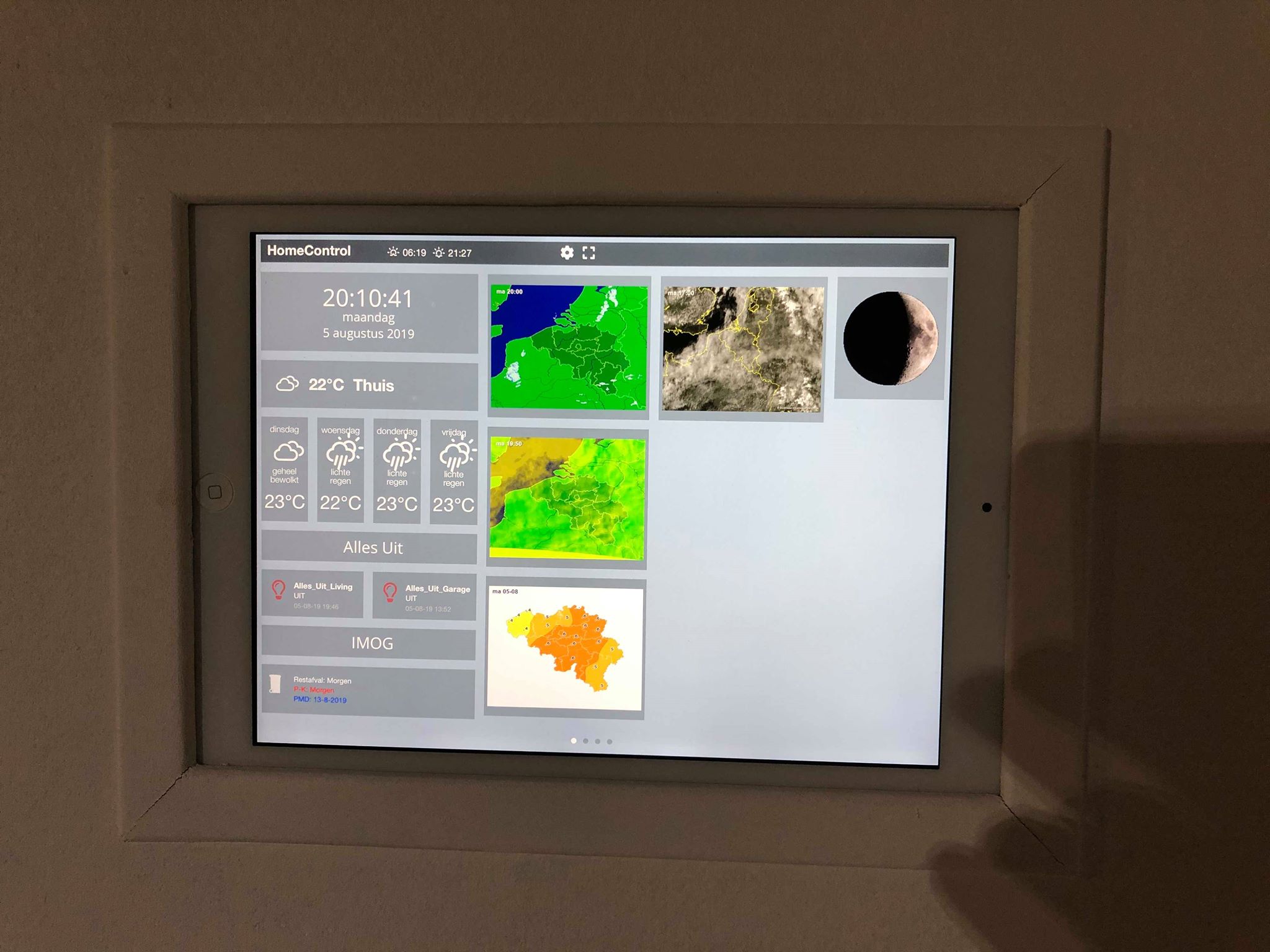

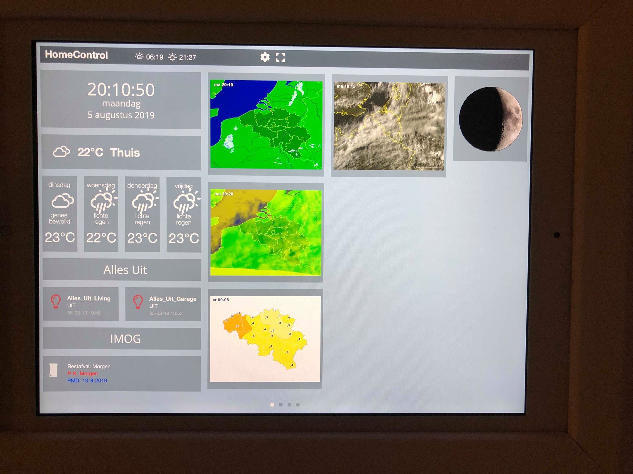

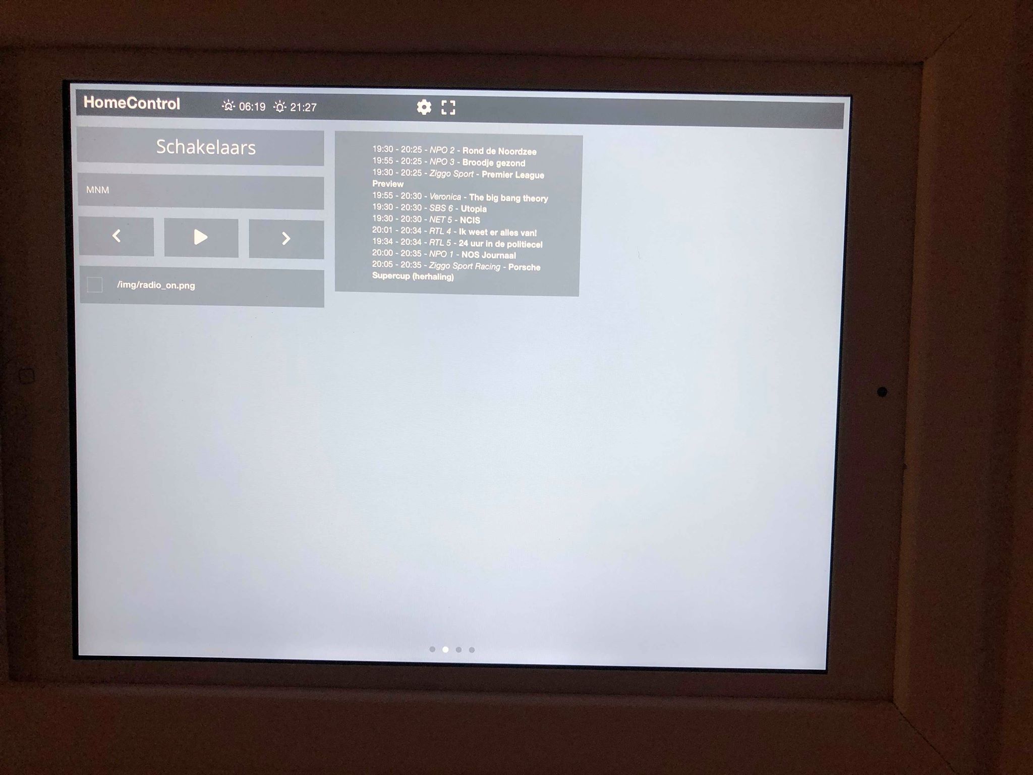

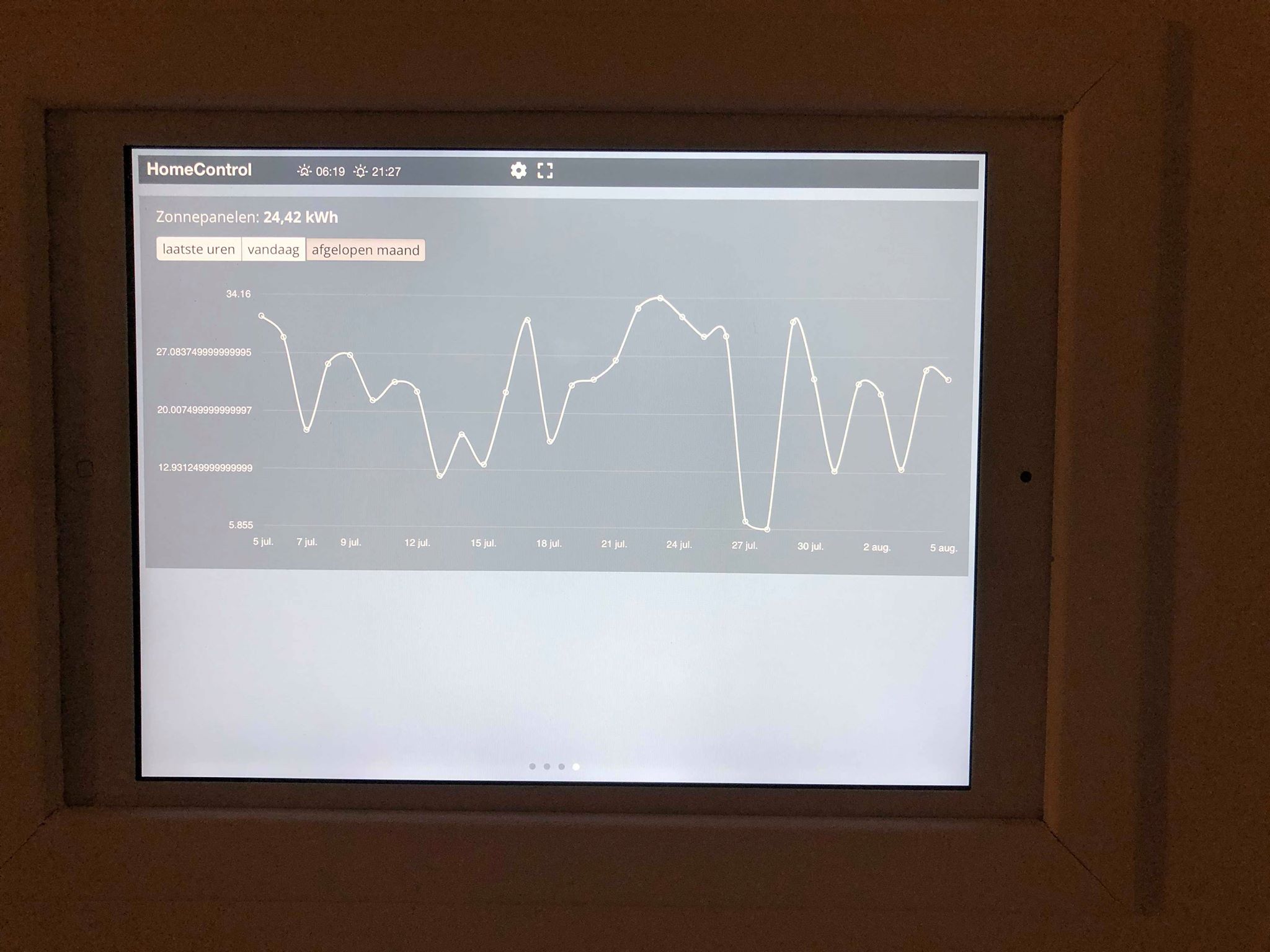

after 1 year i decide to mount my setup and install dashticz again.
now on V3 and mounted i decide to show my setup.
Its basic and need some css mod but it's a start.
Gianni
- Posts: 230
- Joined: Saturday 21 July 2018 19:03
- Location: Home@Belgium
Looks like i can only post 3 image in 1 post
Lokonli
- Posts: 2296
Nice
I'm working on an update of the graph module. That will make the numbers on the y-axes look better.
