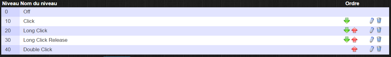

Damned you are right, they have the same IDs as doors/windows sensors !
Regarding the wireless switch, actions seems to be in the correct order:

lamouette wrote:Damned you are right, they have the same IDs as doors/windows sensors !
Ok solved. Just remove the doors/windows sensors + the "new" items and after a refresh, only doors/sensors came back :mrgreen:
For the wireless switch, problem also solved with the same method.

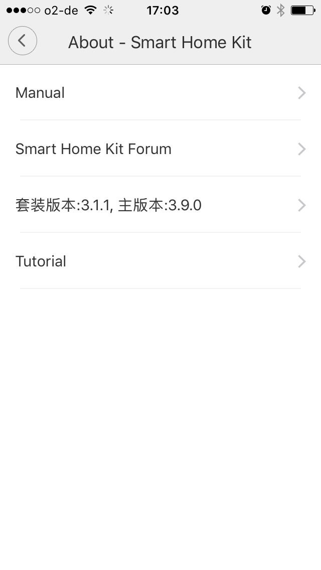

Hi mates,
noop question !
Is it possible to turn on lan-options of the gateway via iPhone and Mi App ?
(as told in Domoticz wiki "tap the toggle switch to enable LAN functions...." but doesen´t work for iPhone)
Gateway is V2, app is V 3.9.0
Is it possible to get the lan-password of the gateway via iPhone app ? same problem.
Or: Is there another way ton enable lan and get the PW.
THX for your help,
kind regards,
Michael

Hi Michael,
Same way as for the android app.
Inside the application, go to the Gateway, click on the 3 points on top right and choose About.
Give 5 quick click on the middle down off the application and the hidden menus will appear.
Choose the one in the middle, just under ":3.1.1,"
drmabuse71
Posts: 10
Joined: Sunday 29 January 2017 8:22
Post by drmabuse71 »
@lamouette
first of all: THX for your detailed and quick support - GREAT !
But this doesen´t work for me. This happens:
Screenshot
Screenshot
No such menue for me.....
But perhaps the mistake is somewhere else ?
App is Ver 3.9.0
Gateway is ver 1.3.0_124.0140
I´m a little bit - helpless :-(

drmabuse71 wrote: But this doesen´t work for me. This happens:GetFileAttachment.png
Have you tried this:
Select your Gateway in Mi Home, then the 3 dots at the top right of the screen, then click on about. Tap the version number at the bottom of the screen repeatedly until you enable developer mode - you should now have 2 extra options listed in Chinese. Choose the first new option, and then tap the toggle switch to enable LAN functions. Note down the password (91bg8zfkf9vd6uw7 in the screenshot). Make sure you hit the OK button (to the right of the cancel button) to save your changes.
(From the wiki: https://www.domoticz.com/wiki/Xiaomi_Gateway_(Aqara))
drmabuse71
Posts: 10
@galadrill
THX for your response, but doesn´t work for me.
1) There is no version number shown at the bottom of the "About" page
2) by clicking 5 times fast a hidden menue appears, but not the suggested one
Do I own perhaps a Gateway version 1 ?? Wlan shows "lumi-gateway-v2_miio1212303" - so I think it´s a V2.
Country is set to China ......
