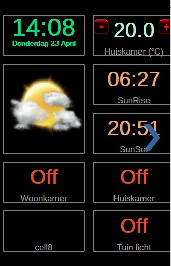

It is good to use your own settings.js from your original post - just take your last download.
The settings are updated a lot - dimmers - images - blinds
just upload my files into your exsisting (frontpage) www map and it should work.
i think you don't need my settings, my idx are different than yours let me know if this works?
My complete layout is a lot different that this original frontpage file.
(you will see on mobile also the borders are different)
you can change the custom col and row in the bottom of the HTML

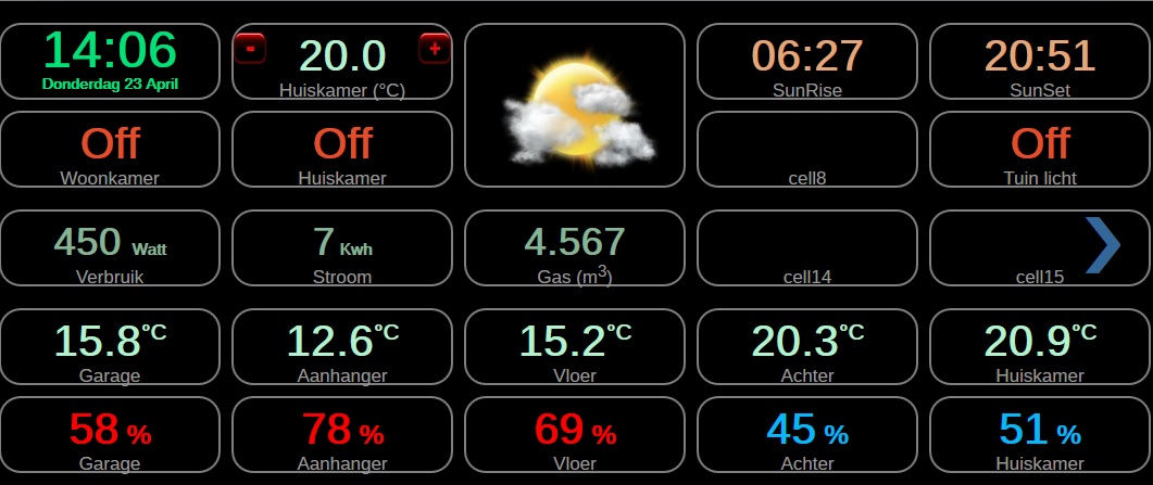

The link is not working anymore, can you provide us a download link for the latest version? Thnx!G3rard wrote:Here is the link were youy can download my frontpage.
http://www.filedropper.com/frontpagegz
The frontpage has a.o. the following changes compared to earlier versions posted in this topic.
- text with cell description changes according to the state (eg alarm on/off, sunrise/set)
- removed bounce effect (no vertical scrolling) on iPad
- use extra div's in the cells above (see also the post from zicht) to show 2 values in one cell
- various layout changes
Let me know if you have any questions regarding the configuration.

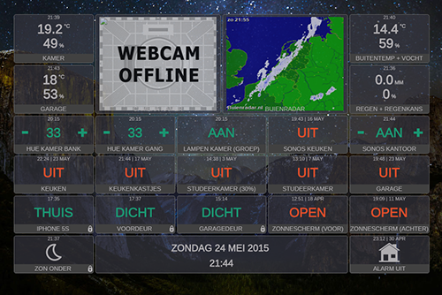

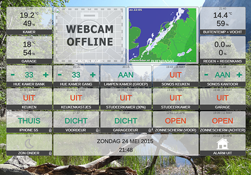

Here is the link to my updated frontpage.
http://we.tl/Hl5AoKa7Md
Remarks:
- I have added some code in the frontpage.html to use a different css when the browser is Android. This is to nicely fit the frontpage on my Nexus 7.
- I have added code in frontpage.js to support my Sonos speakers. This is enabled when you choose 2 as a value for the plusmin buttons in frontpage_settings.js. The php code I use is from this forum topic http://www.domoticz.com/forum/viewtopic.php?f=38&t=6088
- When you use Firefox (I use Chrome) the allignment of MM, %, C is not as it should be, you have to change the allignment in frontpage.js (e.g. line 384)
- When you browse on your PC, you can use the left and right keys to switch between the pages
- When the switch is last seen on the current day, then only the time last seen is shown, otherwise also the day is shown
- The plus and min buttons for a dimmer or the Sonos are only shown when the switch is on
- You can place the files anywhere you like. I have my frontpage running on my Synology webserver which is a different folder then Domoticz is using
