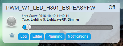

below my way to drive W1 & W2MadBanana wrote:ledfreak3d - just checked mine with Domoticz and the same as you, white doesn't work. I'd only previously used it by sending this ..
http://192.168.1.92/control?cmd=PWMFADE,3,500,5 - which lights the strip white, attached to W2
Not sure what to do in Domoticz though, RGB on the wheel works fine.
First create a dummy LightWave RF dimmer
second made a script_device_w1.lua script, or use LUA editor on Domoticz (don't forget to save as de device one)
DomDevice = 'PWM_W1_LED_H801_ESPEASYFW'; --your dymmy LightWave RF Dimmer
IP = '192.168.0.196'; --change for your h801 ip
PIN = "4"; -- for w1 pin
if devicechanged[DomDevice] then
if(devicechanged[DomDevice]=='Off') then
DomValue = 0;
DomValue = otherdevices_svalues[DomDevice];
CalcValue = (DomValue-1) * 33;
if CalcValue==nil then CalcValue=0 end
runcommand = "curl 'http://" .. IP .. "/control?cmd=PWM," ..PIN.. "," .. CalcValue .. "'";
os.execute(runcommand);
print("PWM value= "..CalcValue);
return commandArrayDomoticz stable 3.5877 for real & Domoticz beta for test

BUT found the milight hardware device in domoticz is very strange - changing the device mode from rgb to rgbw to white etc incorrectly creates new devices but the main problem is simply creating a milight hardware device and changing its mode to white results in a dimmer that doesn't work (doesn't send udp packets)! You have to change the mode to rgbw and rgb then back to white first?! Even then depending on the sequence it may end up sending different udp packets as the slider is adjusted. Also, only 32 steps for the milight dimmer...
Shame as it would have meant I could have got rid of my script to handle the white channel and also the uservar to work around the on "feature" of not sending the level...
