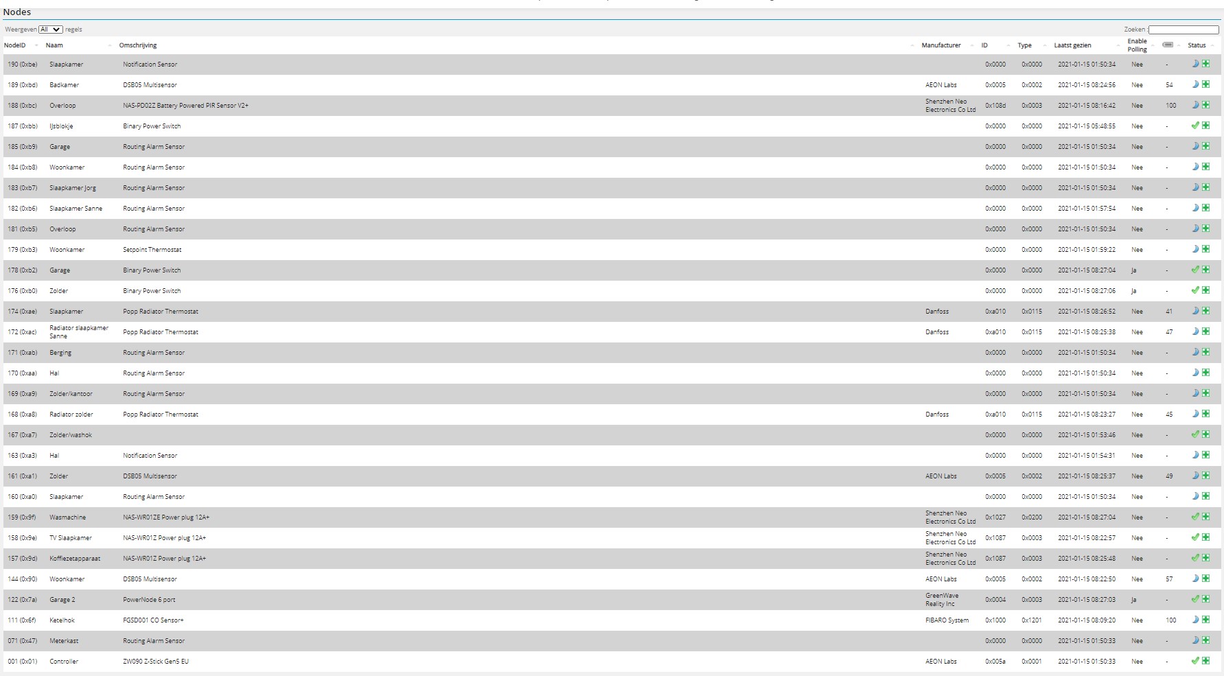

Not sure if this helps in the discussion. I'm running Domoticz 2020.2 with OpenZWave USB Version: 1.6-1033-g3661f170 and mainly Fibaro Zwave devices (only 2 Qubino) and I'm having no issues at all. It is all running stable and I can control everything how I want to. I do have the nightly heal network enabled, maybe that is the difference.
Screenshot 2021-01-18 at 14.33.24.png (136.36 KiB) Viewed 1920 times
