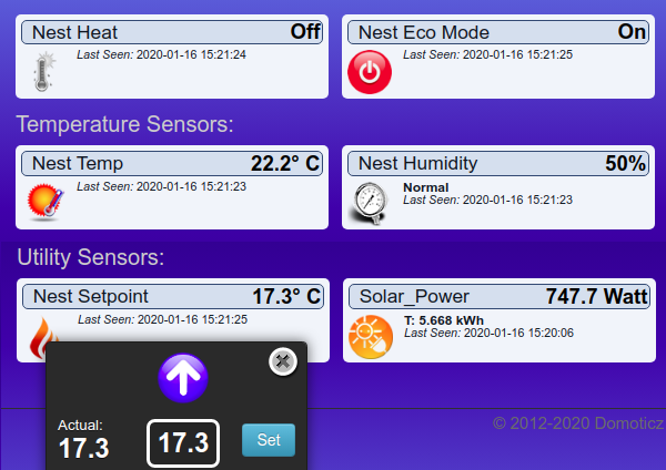

can't get the plugin working, Domoticz hangs after some minutes.
So waiting for official Domoticz Nest-Google support, I used the original php code from https://github.com/gboudreau/nest-api
created some virtual devices: switches, temp, Humidity and setpoind, build a unix cron-script arround it to update the device via the Domoticz json api.
also a a trigger script to enter eco-mode if no one is at home, and a dzVents event to change the setpoint
works pretty fine!
if you'r like it, code is below

Hi Roland,
You missed one hardcoded idx in your script for setting the setpoint.
Since I needed the Eco mode switch, this is very helpful! Many thanks as well.

heggink wrote: Thursday 16 January 2020 23:59 Hi Roland,
H
Hi Heggink, which one are you missing?
both setpoint and eco-mode are there, I both use them,
set-point will trigger a dzvents script, which calls a phpfile to set the set-point, see the readme
the eco-mode switch self starts the enable/disable scripts, see the pictures and the readme
