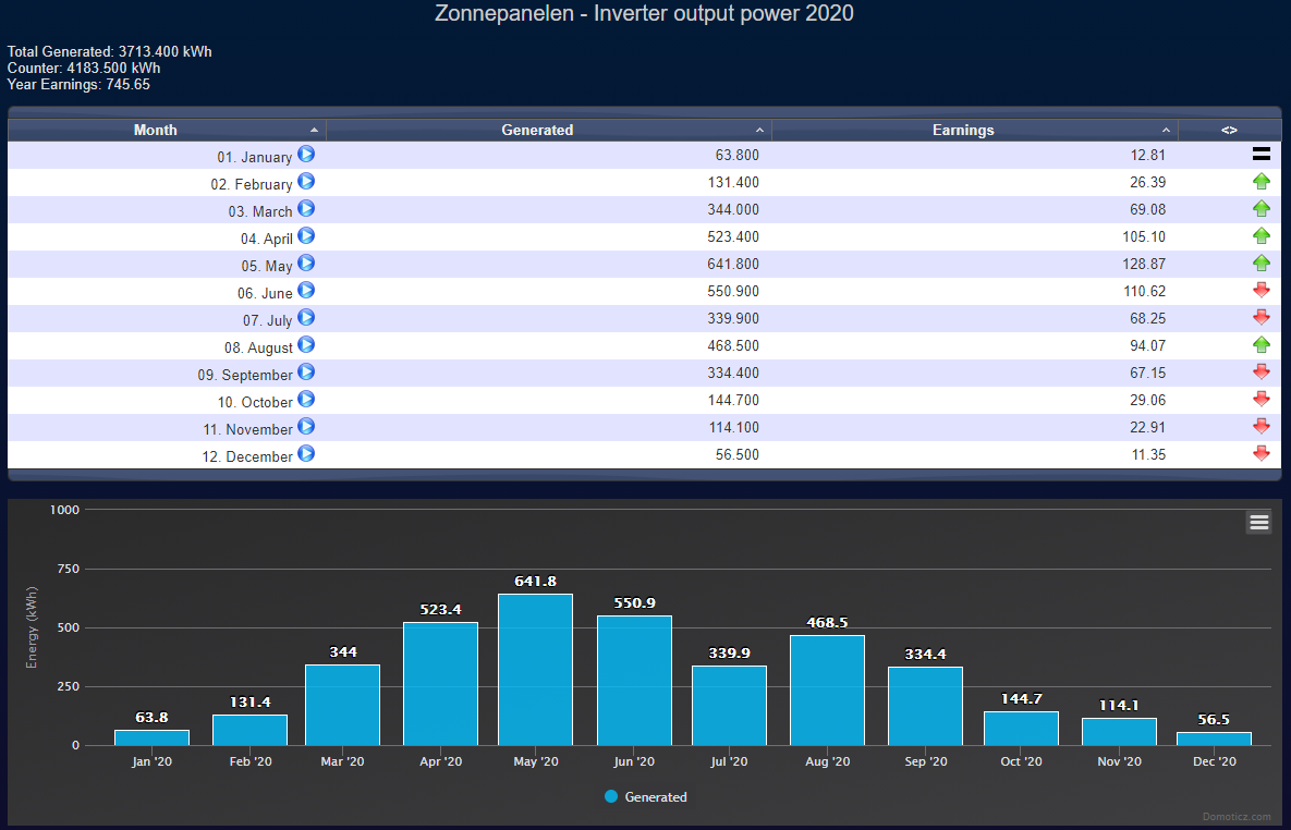

JanJaap wrote: Friday 04 September 2020 8:24 Hi,
The 'bad file descriptor' error comes from trying to do something to a file without the right access to it. It happens once in a while, I think it comes from the GoodWE API not returning the correct data or somewhere the software tries to store it where something goes wrong. I need to dive into that a bit more. At least catch the exception a bit more elegant. I'll let you know when I found something.
JanJaap, plugin works perfect! Now I'm trying to get also the amount earned in euro's in domoticz, so I adjusted some script (https://ehoco.nl/stroom-gas-en-waterkos ... -domoticz/) and used the device of my solar panels also with the 'CounterToday'.

Not sure as to why you want to do this, since Domoticz offers this out of the box (although not on hourly level but for me I only want to know the total score):
Solar panel earnings.png (149.78 KiB) Viewed 2783 times
It is under log -> report of the power widget of the solar panel
The for your question; the error says that the local variable 'vandaagKwh' has no data assigned. This is no issue of the plugin but your script (you mention you changed the one from ehoco so it is not possible for me to see what is going on). I propose to post it in the forum of the ehoco page?
As a hint to debug: try printing the contents of the variables to logging of Domoticz, LUA should have features for that and see where you loose the data.
