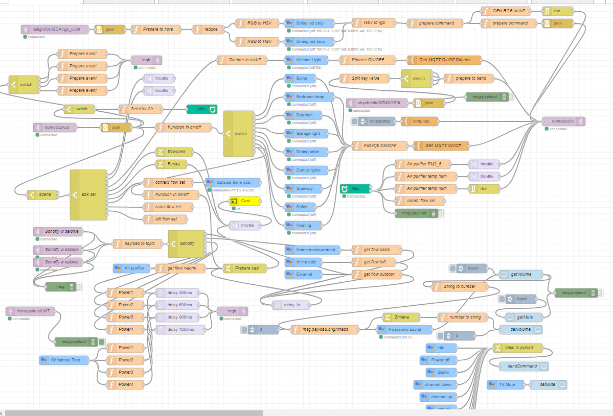

Take a look my nora usage and control switches, lights, Panasonic TV etc.:
As you see nora nodes are between domoticz/out and domoticz/in topics.

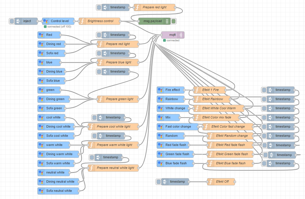

On the second screen is to control RGBCCT led strips using milight hub plugin https://www.domoticz.com/forum/viewtopic.php?t=27771
If someone interested I can share my flows, but before I have to make sure not leave any tokens etc.
I use more than 50 nora nodes.
FireWizard

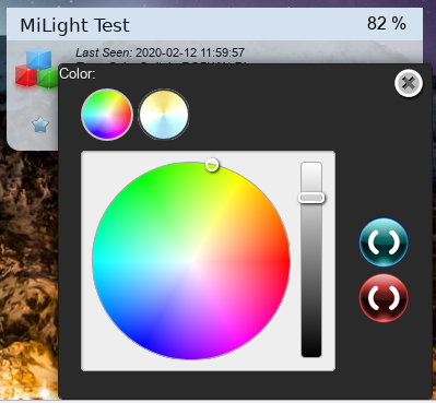

As promised, I will share my solution.
I had to test it in a full operational environment and therefore I will not distribute the MQTT input and MQTT output nodes, as this will interfere with your MQTT configuration.
I tested it with a virtual switch, which gave the same MQTT response, as you presented.
As you click on the 3 colored cubes, the screen with the color selector will open.
You have to select the left circle. The right circle is for cool white and warm white, but will not function for this light.
