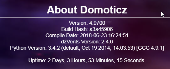

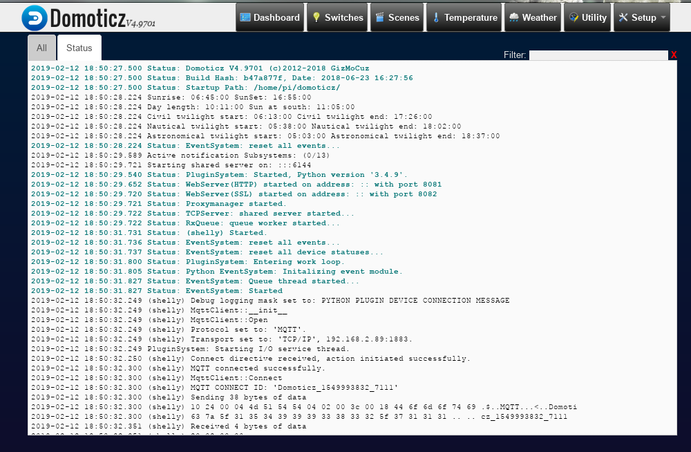

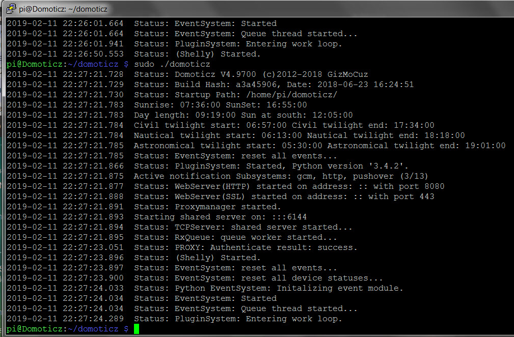

Installed a Shelly 2 yesterday and got it connected to my mosquitto broker running on Pi3(same as Domoticz). Subscribed with another client to verify....
I have installed the plugin and configured it but as soon as i start/enable it Domoticz will stop.
Running latest stable Domoticz and a verison of Python that should work(if I got it right). Have tried to disable all the other plugins as a test but no success.
My installation works perfectly and there are no issues with any other plugin. Strange....what suggestions do you have?
The current Firmware version of Shelly device is 20190208-145233/v1.4.6@a030bf96 No newer firmware available. Domoticz:
Fourth row from top is Domoticz stopping when enable and update. Then tried to start it again.

swejmansson wrote: Monday 11 February 2019 23:01 I have installed the plugin and configured it but as soon as i start/enable it Domoticz will stop.
Looks like that something at the Init section is not working well, as plugin related messages comes after "Entering work loop".
mqtt.py was changed last time, with one new parameter, can be a problem if an old mqtt.py located near plugin.py.
In 0.3.2 i've added more exception handling to throw some error messages at the init stage to give some idea about the problem.
Altough Python 3.4.2 is not so fresh i've found 3.4.9 as the oldest possible to install onto an Ubuntu 18.04. Python 3.6.7 works well based on user feedbacks:
https://github.com/enesbcs/Shelly_MQTT/issues/5
And please enable plugin DEBUG setting when you try to send some error reports...
However mine installation works well with Python 3.4.9:

Did some further tests tonight....
Removed folder plugins/Shelly_MQTT, installed it again. Enabled debugging for plugin, tried both alternatives, the log in domoticz still looks the same.
Domoticz stops after "Entering work loop".
Did some research on changing the logging level for domoticz, but did not succeed.
Think I will clone my card and try to install Python 3.6.7 into my Rasbian Stretch Lite setup. Last time I tried to update Python I had issues with libssl version and compatibility with domoticz.
Had hours of not fun :cry:
Strange everything else is working great, no issues with other Python plugins. I will NOT give up! :D
