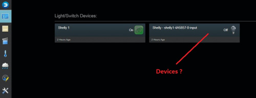

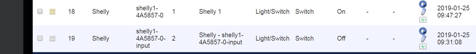

Hi @lwolf
I installed the Python plugin to integrate Shelly MQTT with Domoticzem. Now I have to test only Shelly 1.
The plugin works, and I'm glad I only have a question
Why the plugin adds new 2 device?
The first is a switch and is Ok
What is this second?
Sorry for my English I'm Polish and I know the language
Intercede photo for a better understanding of the

besix wrote: Friday 25 January 2019 12:26 The plugin works, and I'm glad I only have a question
Hi!
From firmware version 1.4 Shelly supports "detached buttons".
The normal behavior is that "input" and "relay" state is equal, when the Shelly switch (SW) input changes, than the relay output will change. (of course there are also selectable multiple button behaviou switch/momentary in the Shelly WebGUI)
In detached mode, if you press the Switch on Shelly, than it reports back the changes to the MQTT server, but do not change the relay state.
This device is created by the plugin automatically, but can be changed manually to "not in use" state. (if you delete it, the plugin will recreate it, as shelly's publishes it's state)

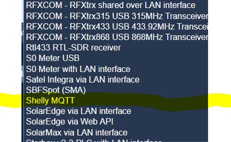

@Iwolf I seem to have no luck getting the Shelly to report back to Domoticz. No new device is turning up.
I attache some screenshots on the config, probably some mistake from my side, any help appreciated.
192.168.1.22 is the IP of Domoticz
/lennart
/lennart

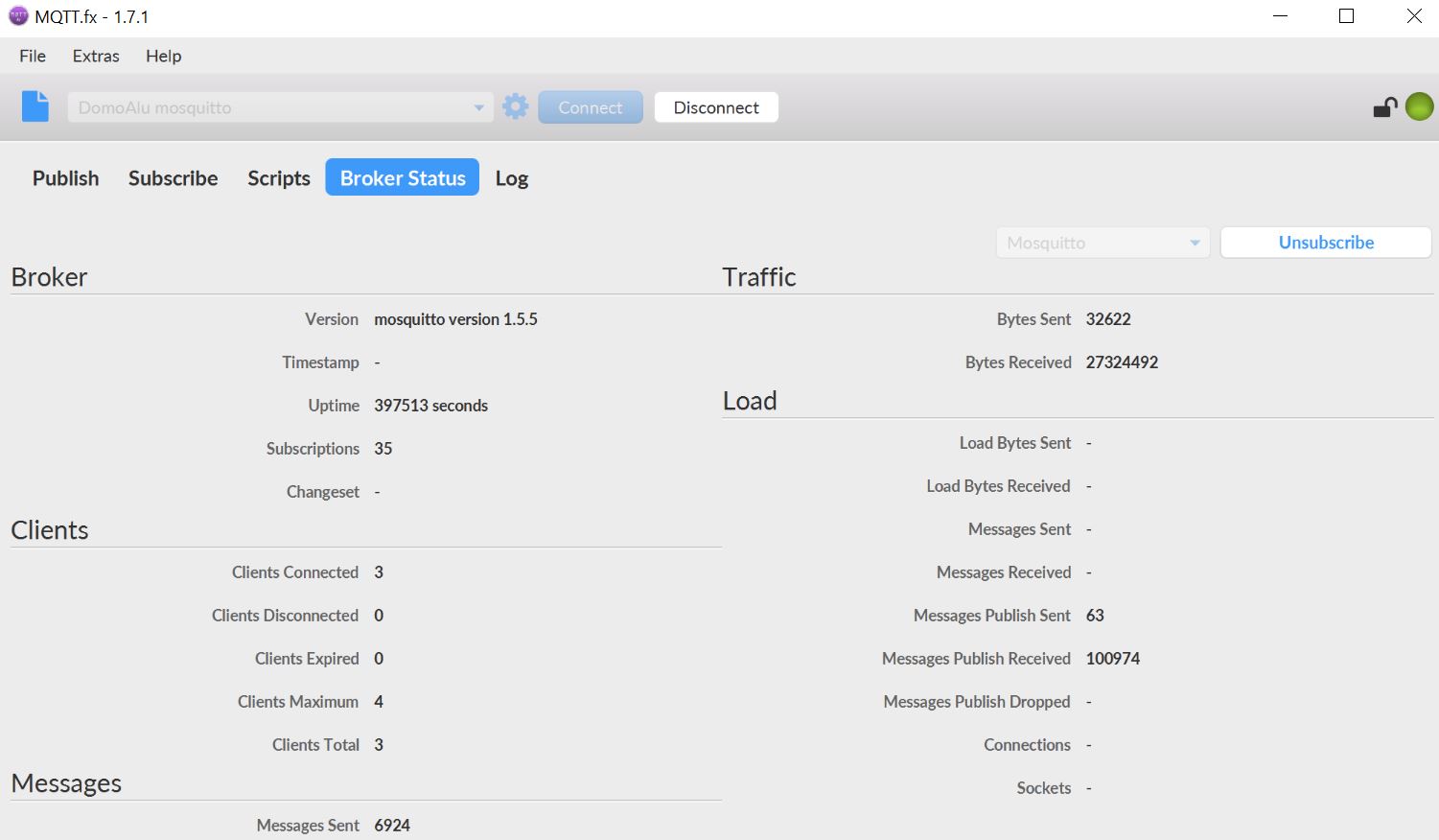

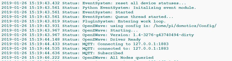

Hi again, did like most here i guess and scanned internet for knowledge. I have not been able to solve why I cant get the Shelly up in the device list but fund a test tool that might say something to someone more knowledgeable than me.
The tool detects both the broker and the shelly client, it also say that the broker has 3 clients indicating that it is my 2 shellys and the test tool that is connected (well this is my armature conclusions).
What could I have missed in the phyton part that is typical beginner mistakes?
Accept hardware is on:
Subscribing to the Shelly works:
The broker also looks ok as far as I can tell:
Anyone that can point me in some directions?
/lennart

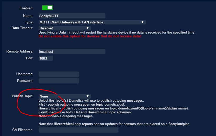

Finally solved :-) Unfortunately I cant be sure what solved since I made the mistake to do several changes between testing.
I did fiddle with the Python though.
1) made a new install and compiled the package on the rpi
2) installed "sudo apt install python3-dev"
3) Added this line "alias python='/usr/bin/python3'" to the .bashrc that made Pyhton3 as default version to be used
after this actions an a reboot a new HW turned up in the list:
Then toggled the Shelly and they all poped up as they should, great!!
I did however see when I hade the MQTT.fx tool running that Domoticz published sensor info on the network.
To minimize interference I therefor changed broker publish to "None"
Many thanks for the plugin @iwolf
/lennart

leby wrote: Saturday 02 February 2019 12:37 I did however see when I hade the MQTT.fx tool running that Domoticz published sensor info on the network.
I am very glad, that you can make it work.
But i am a little confused about the second image in your post. ShellyMQTT has nothing to do with "MQTT Client Gateway with LAN interface". And in fact they are using different topic's (shellies/#, domoticz/in, domoticz/out) and it is unlikely to ever interfere with each other's operation. Unless you are using the same IDX that Domoticz assigned to a Shelly device in an other device also, such as a Sonoff-Tasmota through standard MQTT. :D
leby
Probably only me that misunderstood how to set it up in the first place. Do I understand you correctly that I can scrap the "MQTT Client Gateway with LAN interface" and only using the HW "Shelly MQTT"?
btw, have Allterco Robotics supplied you with a 2.5 version so we can expect support for that one also?
/lennart

leby wrote: Monday 04 February 2019 14:22 Probably only me that misunderstood how to set it up in the first place. Do I understand you correctly that I can scrap the "MQTT Client Gateway with LAN interface" and only using the HW "Shelly MQTT"?
Yep, MQTT Client Gateway with LAN interface only for devices that supports Domoticz (ESPEasy, Tasmota, ESPurna...).
Shelly is another one, which uses MQTT an other way, this is what ShellyMQTT understand. As you can see the installation instructions page:
https://github.com/enesbcs/Shelly_MQTT
there are no mention about MQTT Client Gateway.. as it is not needed.
