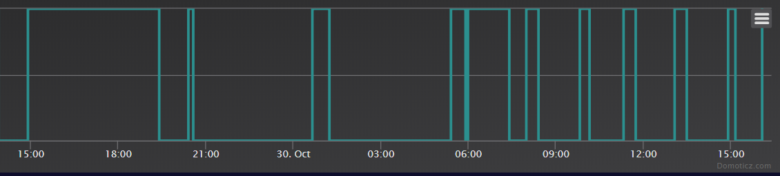

So far it is working great.
Below a graph of the heat demand switch.
Last heat demand yesterday evening was at 20.34
At 22.00 we went to sleep and all temperature setpoints are lowered except the sleeping room of our son, which is set to 19°C.
As you can see only once during the night (00.39) heat was requested to keep the sleeping room on it's setpoint. Next time was in the morning around 5:30 when the setpoint of the living room goes up to 21°C.
Since I'm at home this week, the heating in the living room is set to 20°C during the day, so about every 2 hours there is heat demand to maintain this temperature.
So I couldn't be happier for the moment.

After testing the script for 48 hours I do not find more frequent temperature taking.
You should indeed use the (axact!) names of the mode switches in Domoticz. To make sure it's actually running: If you look at the history of the mode switches, do they indeed change position briefly every hour? In my case it seems to help a bit. I'll disable the script tonight to see the difference.
