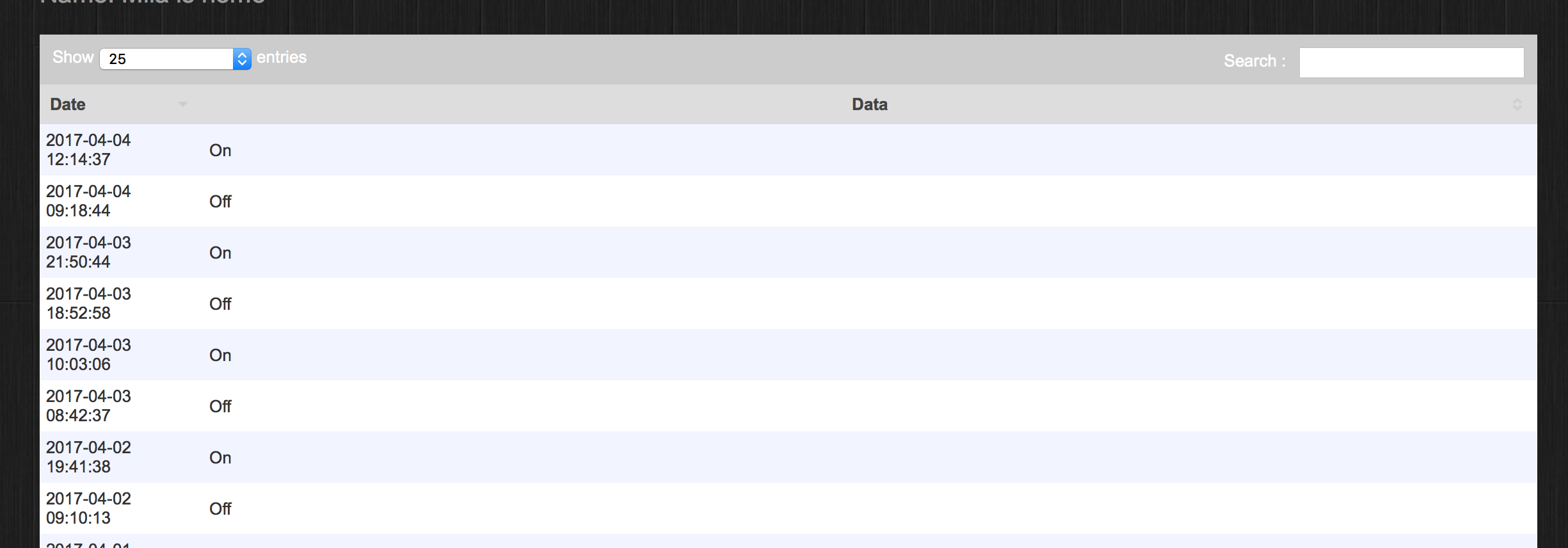

I think the date column should not be wrapped.
Screen Shot 2017-04-04 at 14.01.32.png (196.31 KiB) Viewed 4861 times

Re: New "progress" theme.
Posted: Wednesday 05 April 2017 15:22
by blauwebuis
@gerard76: the weird wrapping of the column is on the list. It's 'fixed' inside the html. I could force-override it with CSS. I've spent some time looking for the javascript that generates that odd spacing, but I haven't been able to find what generates it. Anyone have any ideas?

blauwebuis wrote:@gerard76: the weird wrapping of the column is on the list. It's 'fixed' inside the html. I could force-override it with CSS. I've spent some time looking for the javascript that generates that odd spacing, but I haven't been able to find what generates it. Anyone have any ideas?
@blauwebuis, the problem is in the file base.css. When I remove the line * {box-sizing: border-box} in the /* GENERAL STYLING AND RESETS */ section, than the weird wrapping is gone. But.... I cannot see if this has impact on others things, so succes with the search...
