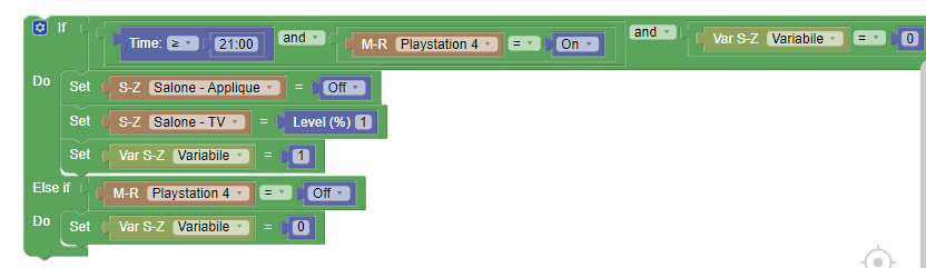

This is my blocky:
if time it's more than 21 and my playstation 4 is on, it active a scene that switch off all lights in the home and switch on the light near tv.
But now I have a question; I see the log and this blocky runs every 2 minutes more or less, so there is no risk of ruining the light bulbs that receive continuous commands?

You could add a variable to let
Know Domoticz that event has run and no need to keep issuing commands to the lights.
A bit like: if PS4 and >21 and userVar = 0 then
Switch on light and set userVar=1
Just make sure to reset userVar to zero when no longer the event applies.
Hope it helps
11101101 - www.machinon.com

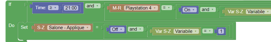

Done, but script says : Error: EventSystem: Lua script error (Blockly), Name: Playstation_Accesa_1 => [string "result = 0; weekday = os.date('*t')['wday']; ..."]:1: ')' expected near 'comparevariable'

You can also do in the first line IF tv=off and time........................
Then it will not start it again because the tv is already on

corederoma82
Posts: 85
Joined: Saturday 14 January 2017 21:34
Re: Blockly examples
Post by corederoma82 »
What I wrong?

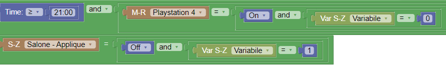

You cannot do a SET Salone = Off And ...
This needs to be 2 separate set rows, one for the Swich and one for the variable.

How is possible create 2 separate set rows?
Raspberry PI 3, 3x Yeelight bulbs, 1x Yeeligh led strip, 1x Sonoff with ESP826, Controlicz, Kodi
jvdz
Posts: 2351
Domoticz version: 4.107
Post by jvdz »
Just drag and drop 2 separate set command.... as simple as that!.

Done!!!!! It seems to work properly.
