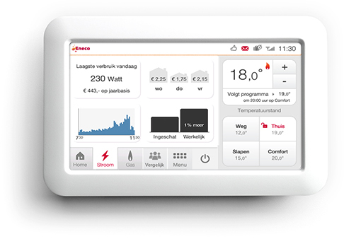

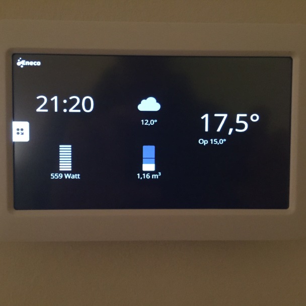

A very nice project! I want to replace my eneco toon with a raspberry with the original touchscreen and put in on the wall in my living room. The toon also have a stand-by view which is black and white and is very usefull when it is not in use and still can see the time etc without having a bright screen at the wall. Is there also an option available in this dashboard which opens a simple few after a few minutes. Please see the screenshot as an example.
Active:
Standby:
toon standby.jpg (57.95 KiB) Viewed 1894 times

Blueone wrote:The toon also have a stand-by view which is black and white and is very usefull when it is not in use and still can see the time etc without having a bright screen at the wall.
Not possible at the moment but will add this asap!
