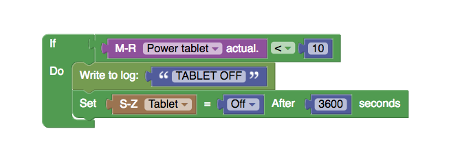

Has anyone got read power working?
I'm trying to do this:
Screen Shot 2018-07-31 at 21.46.03.png (29.71 KiB) Viewed 4081 times
I have a wall tablet with an inline aeon smart relay. When the tablet is charging, it usually charges over 10 Watts. I want to disconnect the power of the power supply after 1h when its power consumption drops below 10 Watts (about getting fully charged).
I have this tablet always on and charging, and I'm having problems with it I think due to overheating (always powered to the power supply).
The first part of it: if power < 10 does not seem to work in blockly for me, is there a way to get the power reading?

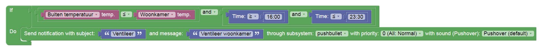

I'm trying blocky to have domoticz send me a notification when the outside temperature gets below the temperature inside the house, so I have to start opening doors and windows. I'm using blocky as I have no idea how to program in Lua. However, I can't get it to work properly.
I have setup a virtual switch (Woonkamer_Temp) that is set to ON when outside_temp < livingroom_temp AND time is between 18.00-2330 hrs
In the virtual switch (Woonkamer_Temp) I have setup a notification when it switches to ON
The switching part works like a charm, however I keep getting notification every minute or so. I can see in the log that the 'Woonkamer_Temp' switch is polled all the time, hence sending a new notification every time. How can I prevent domoticz from doing that? I just want to have a notification one time. Can't get it to work in blocky.
Version 1
Version 2

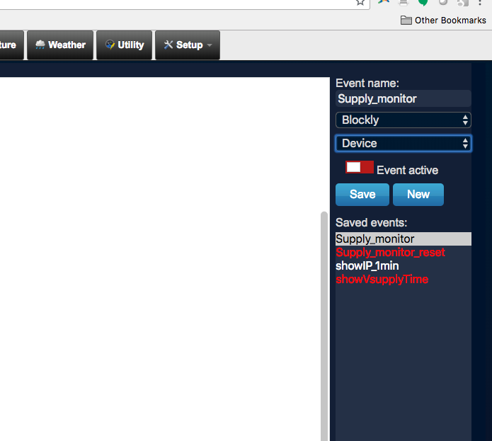

Make sure you select the right trigger event (device, time, etc...) on your blockly diagram

EdddieN wrote: Thursday 02 August 2018 16:30 Make sure you select the right trigger event (device, time, etc...) on your blockly diagram
I'm sorry, can you elaborate? I'm fairly new to this. What I would like doesn't seem too difficult in my mind, but the blockys I made don't work. They keep repeating. I just want domoticz to send me one notification...it sounds so simple, and in Lua it is perhaps, but I can't figure out programming like that, i'm sorry. So, I'm either hoping for someone to show me what is wrong in my blocky or someone that can show me a lua script for me to figure out.

by waaren
henk99 wrote: Thursday 02 August 2018 16:26 I'm trying blocky to have domoticz send me a notification when the outside temperature gets below the temperature inside the house, so I have to start opening doors and windows. I'm using blocky as I have no idea how to program in Lua. However, I can't get it to work properly.
Your blockly does switch your notification triggerdevice every time the temperature condition evaluates to true.
Using the checkFirst option in dzVents you can prevent that . This small dzVents script should do the job.
--  activateNotificationSwitch.lua
         on = {   timer   =   {"every minute between 16:00 and 23:30 on 15/4-15/9"}}, -- during spring and summer
    execute = function(domoticz)
        if  domoticz.time.matchesRule("at 16:00-23:28") then
           if domoticz.devices("Buiten temperatuur").temperature <= domoticz.devices("Woonkamer").temperature then
                domoticz.devices("Woonkamer_Temp").switchOn().checkFirst()
            domoticz.devices("Woonkamer_Temp").switchOff().checkFirst()

No worries! Here, under blockly you have many options there how to trigger the event

by henk99
waaren wrote: Thursday 02 August 2018 18:08 Your blockly does switch your notification triggerdevice every time the temperature condition evaluates to true.
Hi Waaren. thank you so much! I have implemented it in my domoticz and it worked like a charm. Very happy with this!
