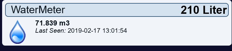

I'm working on my dashboard, but when I add the water meter I don't see the used liters today values but an ? with a total value and not the daily.
Any ideas how to solve this?

pkessels wrote: Sunday 17 February 2019 12:37 watermeter.jpg
Dashticz interprets the Domoticz device information according certain rules, which doesn't always work correctly.
Can you post the result of the following:
http://192.168.178.18:8080/json.htm?type=devices&rid=123
Use the IP address and port of your own Domoticz server. Replace 123 with the Domoticz device ID of your watermeter.
