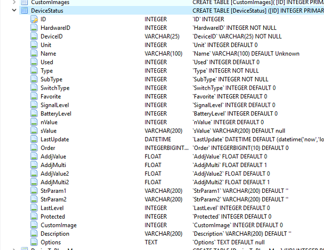

@corbin, @deennoo found a problem for the ctrl_neutral1 - it wont be triggered as the message is hardcoded for ctrl_neural2 only..
im tryng to resolve that, however i cant figure out if there is a way, to store the "ctrl_neutral2" or "ctrl_neutral1" on the InsertUpdateSwitch function to the DB.
and get them either as query from DB or any other method when "WriteToHardware" is triggered.
Seems that when WriteToHardware is triggered from the UI, there is no correlating message from the gateway that i can parse and understand if its the single or Dual device..
the info i found there is mainly the ID, using it i can query DB i assume and get the stored info if ctrl1 or ctrl2 etc..
or there is a simpler way i haven't figure inside the WriteToHardware to correlate to the correct ctrl# device?

levynger wrote:@corbin, @deennoo found a problem for the ctrl_neutral1 - it wont be triggered as the message is hardcoded for ctrl_neural2 only..
Can you check my latest github update hasn't broken the new switch commands you added?
I'm not sure how best to solve the ctrl_neutral/1ctrl_neutral2 problem. I faced something similar with the gateway colour and brightness, where I didn't want to query the database each time for the values needed - ended up using local variables. This approach for the switches would need to store the switch type/name for each switch, and would need an array or similar.
