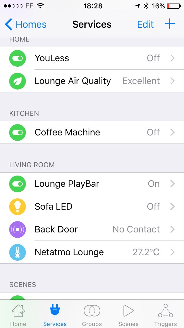

i thought you added youless as 1 of the first items when you first started this plugin, but this is the output for it anyway

and here is one of the air quality

deejc wrote: i think i got it in the post above, thats whats in the log
Head to your homebridge-edomoticz folder, run...
cd lib/
sudo rm domoticz_accessory.js
sudo wget https://raw.githubusercontent.com/PatchworkBoy/homebridge-eDomoticz/mqtt-integration/lib/domoticz_accessory.js
...then restart Homebridge. Air Quality should now be supported and YouLess fixed.
Point to note: MQTT can only update air particulate density as that’s all it sends in the MQTT message. Overall Air Quality (Excellent / Fair / Poor etc) can only be retrieved via a pull-to-refresh / old-style http request.

Post by deejc »
Marci wrote: Head to your homebridge-edomoticz folder, run...
<Snip>
The air quality is actually the part that works :D
youless is still showing "off"
Domoticz 3.5641 on RPI (Raspbian GNU/Linux 8)

Post by Marci »
Repeat...
cd lib/
...then restart Homebridge. Let me know!

Post by deejc »
Marci wrote:Repeat..
nah, still the same except now it says it "on" :!:
