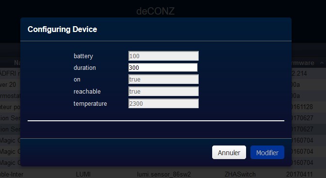

You have them just before ^^
I don't use it, because I know weel the API, but with it you can easier :
- change setting
- delete/rename device (even if this one is not visible in phoscon
- retreive information on device
- list them by sensor/light/group
