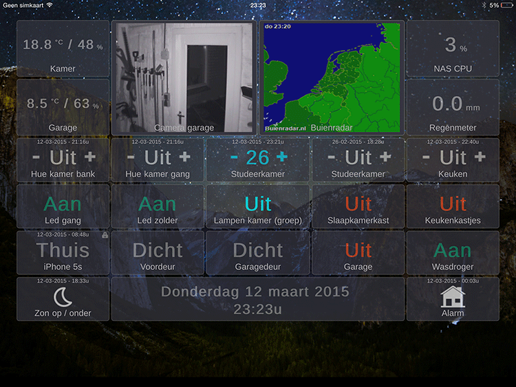

I use both formats on foscam camera :
<div id="cell3"><img src="http://yourIp:yourport/snapshot.cgi?user=yourusername&pwd=yourpassword&resolution=8&t=" onload='setTimeout(function() {src = src.substring(0, (src.lastIndexOf("t=")+2))+(new Date()).getTime()}, 800)' onerror='setTimeout(function() {src = src.substring(0, (src.lastIndexOf("t=")+2))+(new Date()).getTime()}, 5000)' onClick="lightbox_open('camera5', 15400);" width="273px"  class='camera' style='margin-top: 30px;' /></div>
and
<div id="popup_camera5"><img  src="http://yourIp:yourport/videostream.cgi?user=yourusername&pwd=yourpassword"  onClick="lightbox_close('camera5');" width="100%"  /></div>
Both work perfectly fine.
There is one big thing that took some time for me to discover , the camera has limitiation on amount of parallel connections and on data transfer rate ( esp on WIFI)
If you hit one of the limitations you can solve by reducing but in some cases it was needed for me to reboot the camera. I have now a similar setup as in Bewired house,
4 cams (4 side FrontPage with on each 2 cams) buienradar, some traffic info (work in progress) & Still image from last doorbell action/
I run with 2 tables, and android Phone. When also connecting with more equipments it caused some divises to be locked out on the above limitations.
Currently i have broke something to cause the display of cells is wrong on IPhone :(
I am also struggling with amount of data transfer on the page as i also use VPN to connect to my FrontPage. My 1 GB data plan was done within a week ..I think manly due to the camera's. so i have no w special VPN light version without live cameras (switched based on IP dectection ).
Edit :
Please remember to alter the camera field as i have done in above code (camera5) for useing multiple camera's but also create the CSS values for it and in the bottem the popup :)

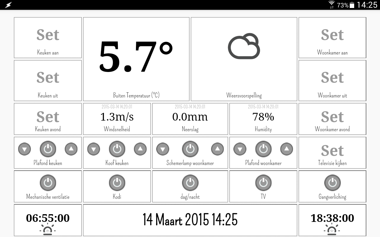

In the frontpage_settings
['0',	'Sunrise',   'cell21',        '','0','0','color:black;font-size:75%'],
['0',	'Sunset',     'cell23',        '','0','0','color:black;font-size:75%'],

Regarding the temp and humidity, it is also possible to show it in one cell with adding some div's.
That's more work, but it gives more flexibility for the layout, see the example below. I am currently working on that.
Not using Domoticz anymore
mvveelen
Posts: 721
Post by mvveelen »
Ah, I see. With the div's is preferable because I would like to try some different layout for these cells. If I change the Temp into Data, the formatting isn't the way I want it to be. Looking forward to the changes you are working on.
