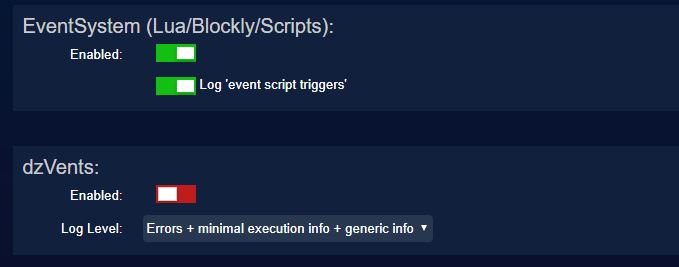

Egregius wrote: Friday 22 December 2017 8:48 Nice, and you're welcome ;)
I do wonder how far you go with it?
A well how far. No deciscion making / no lua / no scripts / no blocky done by Domoticz.
The whole house decision making is done via Pass2PHP. and send to Domoticz.
I still use memcached / opcache so the Pass2PHP basic essentials.
The real advantage is that Pass2PHP can work with device names. So I changed 433mhz to Zwave or Zigbee withou any downtime or modification. Just chanfe the device name and you are using the new sensor as if it was the old one. In addition I start all kinds of plugins in KODI :D . Door opened? SHow a live feed on the tv's that are on. That kind of stuff.
But does that answer your question?

Mmm Domoticz v3.8796
Currently installing a new Raspberry Pi 3 and try to figure out why: "
The solution cbjson64 as described here, is not working anymore.
"https://www.domoticz.com/forum/viewtopi ... 20#p109800"
0. just before cb64json
lua: script_device_sneezydevil.lua:4: module 'cb64json' not found:
        no field package.preload['cb64json']
        no file './cb64json.lua'
        no file '/usr/local/share/lua/5.1/cb64json.lua'
        no file '/usr/local/share/lua/5.1/cb64json/init.lua'
        no file '/usr/local/lib/lua/5.1/cb64json.lua'
        no file '/usr/local/lib/lua/5.1/cb64json/init.lua'
        no file '/usr/share/lua/5.1/cb64json.lua'
        no file '/usr/share/lua/5.1/cb64json/init.lua'
        no file './cb64json.so'
        no file '/usr/local/lib/lua/5.1/cb64json.so'
        no file '/usr/lib/arm-linux-gnueabihf/lua/5.1/cb64json.so'
        no file '/usr/lib/lua/5.1/cb64json.so'
        no file '/usr/local/lib/lua/5.1/loadall.so'
stack traceback:
        [C]: in function 'require'
        script_device_sneezydevil.lua:4: in main chunk
        [C]: ?
even a simple other script like:
--c = ''
--s = ''
--i = ''
--t = ''
--for k,v in pairs(devicechanged) do c = c..k.."|"..v.."#" end
--for k,v in pairs(otherdevices) do s = s..k.."|"..v.."#" end
--for k,v in pairs(otherdevices_idx) do i = i..k.."|"..v.."#" end
--for k,v in pairs(otherdevices_lastupdate) do t = t..k.."|"..v.."#" end
--os.execute('curl -s --data "c='..c..'&s='..s..'&i='..i..'&t='..t..'" http://127.0.0.1/secure/pass2php &')
print("Curl Ended")
commandArray={}
return commandArray
let's Domoitcz hang.
If I remo the script.device.name.lua the system works again.
Maybe something changed..
https://domoticz.com/forum/viewtopic.php?f=6&t=18276
Updated the settings:
Settings
Settings
Pass2php Settings.JPG (23.98 KiB) Viewed 2118 times
At least now i have:
2017-12-29 21:34:05.375 User: Admin initiated a switch command (1/Dummy/On)
2017-12-29 21:34:05.379 (Dummy) Light/Switch (Dummy)
2017-12-29 21:34:05.381 LUA: Curl Ended
So it is showing up again.
