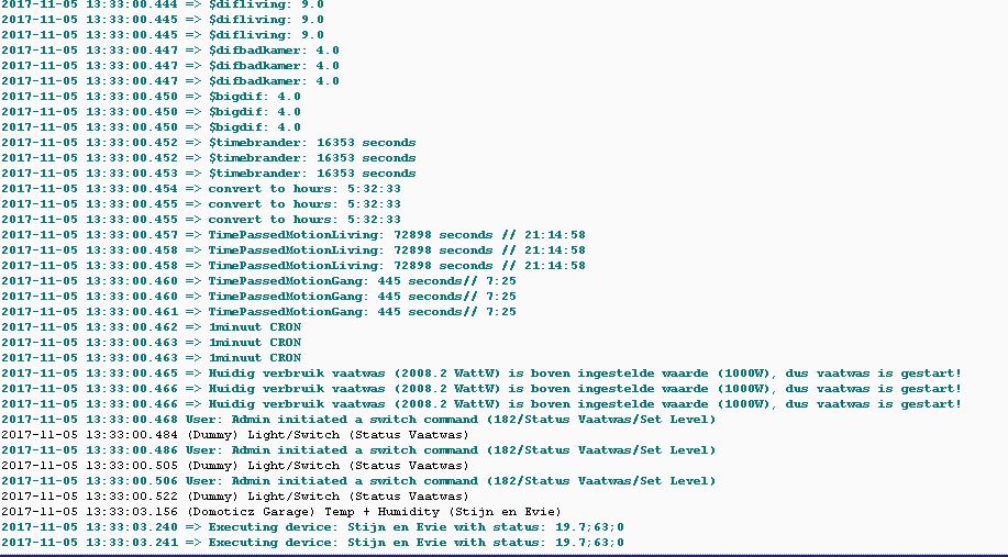

Hi Egregius,
i updated my Domoticz to the latest version => V3.8699
and what i see in the Domoticz log file now is that all commands executed by your php script are executed 2 or 3times after eachother.
Please see attached screenshot.
You can help me by pointing me in what direction in need to look for?
Thanks mate!
2017-11-05 13_33_14-Domoticz.jpg (127.36 KiB) Viewed 2569 times
mosjonathan
Posts: 40
Joined: Friday 24 February 2017 21:20
Re: Pass2PHP
Post by mosjonathan »
fixed in beta 8701
