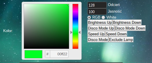

I have just updated to Domoticz official Beta 3,6437 and when playing with RGBW from Gateway, I sometimes see:
XiaomiGateway: Unknown command 17
in the log file. Does anyone know what it is?

mKotek wrote:I have just updated to Domoticz official Beta 3,6437 and when playing with RGBW from Gateway, I sometimes see:
#define Limitless_SetBrightDown 17
What button are you pressing to get that command come through?

mKotek
Posts: 68
Joined: Wednesday 30 December 2015 23:54
Location: Poland
Post by mKotek »
I select RGB switch and press Edit and then Brightness Down button to the right of the color selection.

mKotek wrote: I select RGB switch and press Edit and then Brightness Down button to the right of the color selection.
I'm not seeing these buttons on my dev machine for some reason, but should be able to add in those functions now that brightness control is working.
You can see all of them here:
Screenshot from Edit mode on RGB switch
Screenshot 2017-01-23 at 07.12.25.png (87.83 KiB) Viewed 3494 times
As they are not translated, they might be really new.
Brightness up results in XiaomiGateway: Unknown command 16
Disco Mode Up = XiaomiGateway: Unknown command 8
Disco Mode Down = XiaomiGateway: Unknown command 9
Speed Up = XiaomiGateway: Unknown command 12
Speed Down = XiaomiGateway: Unknown command 11
Disco Mode = XiaomiGateway: Unknown command 13
Exclude Lamp = XiaomiGateway: Unknown command 22
