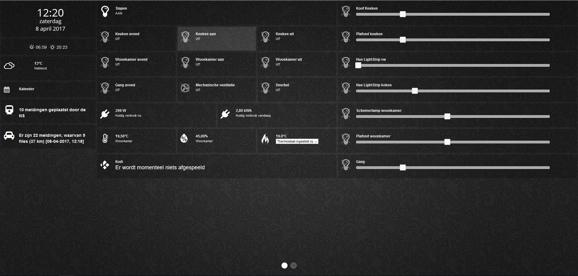

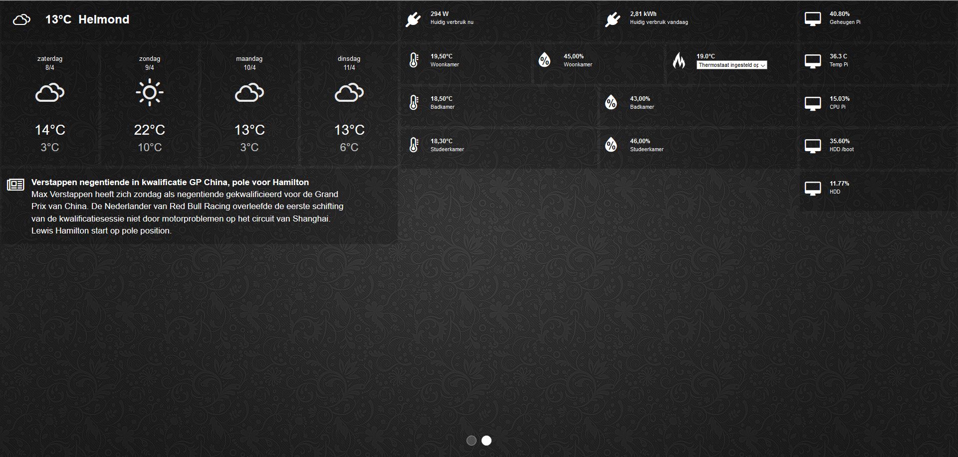

Some screenshots. Not ready yet.
page 1.JPG (286.92 KiB) Viewed 2072 times
page 2.JPG (290.83 KiB) Viewed 2072 times

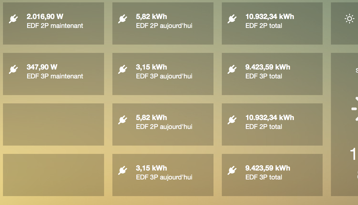

I have an issue when I want to only display energy now in Watt. I use the idx_1 (e.g. '147_1') but I have a empty box follow by today and total. idx_2 for today and idx_3 for total are working fine. When I use 147 without sub value, I can see the 3 boxes working fine.
Can you help me to display only energy now ?
