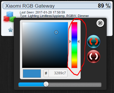

I am facing to an "issue". I cannot save the color of the RGB. It is still blue.
Am I doing something wrong or is it to be considered as normal at this stage?

lamouette wrote: I am facing to an "issue". I cannot save the color of the RGB. It is still blue.
I see the same behavior and think it is due to the colour state not being saved. Have you got other RGB lights that do save the colour?
Also I have just added brightness control to the gateway RGB, and have noticed that if I used the right hand slider, brightness is always sent through at 78%. Has anyone else noticed this?
My update with brightness control is at https://github.com/corbinmunce/domoticz

This is my first RGB device, and yes, that's correct, the color state is not being saved.
I didn't test the brightness.
corbin
Posts: 463
Location: Brisbane, Australia
Post by corbin »
I'm getting the same behavior with Yeelight RGB, so guess this is normal, just hadn't notice before.

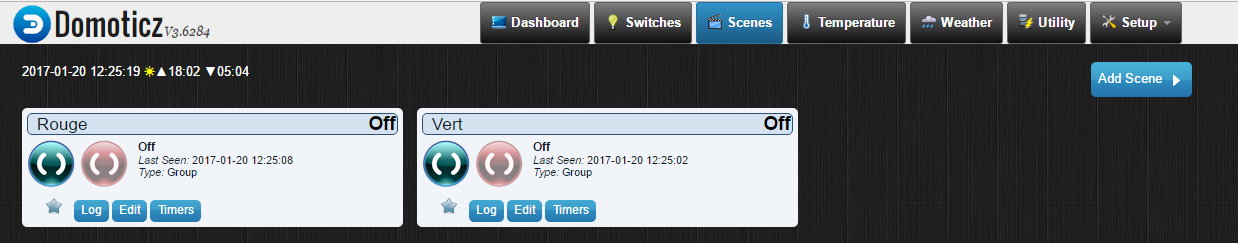

On my side just compil your dev @corbin
looks like playing with brightness slide make it send 100% to the gateway, when it is on 50% in Domoticz
Just adding gateway on 2 groups
one red and one green and color asking is remember by domoticz
http://domo-attitude.fr

Good job guys! I have just seen the RGB has been added!
Is there any plan to ass the alarm/sounds feature?

Post by corbin »
deennoo wrote:On my side just compil your dev @corbin
I've fixed up the brightness control, its working correctly for me, except for when I change the colour the brightness still goes to 78%. https://github.com/corbinmunce/domoticz
