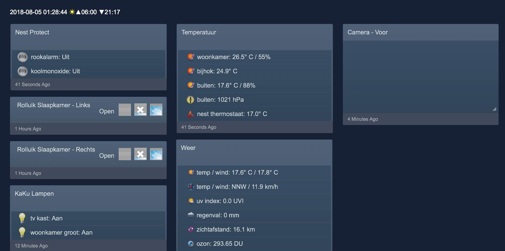

I have trouble adding my two cameras to the Dashboard. I've tried several things (I thought maybe my Hikvision DS-2CD2112-I camera's may be the problem but they work fine everywhere else including the browser).
Screen Shot 2018-08-05 at 01.28.35.jpg (105.69 KiB) Viewed 7265 times
- I've set the substream to mjpg:
* used the link http://IP/Streaming/Channels/102/httppreview (real substream with mjpg)
* used the link http://IP/Streaming/Channels/1/picture (main stream with h264)
- I've set theme modes to Compact and Normal
- Made a virtual switch with a text sensor (with the links instead of Hello World)

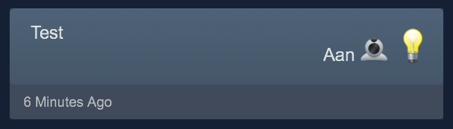

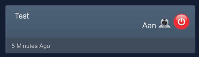

- Tried an on/off virtual light switch with the cameras added to the active scene
- In the cameras in Domoticz, the cameras work fine:
Screen Shot 2018-08-05 at 01.22.35.png (21.69 KiB) Viewed 7265 times
- I made sure that the "camera preview in Dashboard" is set to ON in the Aurora theme settings
- I read something about a bug in domoticz where the link may have to be changed but I am unable to find the escaping characters to do so...
-- Domoticz V4.9797
-- Aurora version (most recent)
Anyone else have an idea how to get the cameras into an iFrame on the Dashboard?

The Aurora theme actually has a special mode for getting camera preview images on the dashboard. But that doesn't use the iFrame feature. Instead, you attach a camera to a switch, and then place the switch on the dashboard.

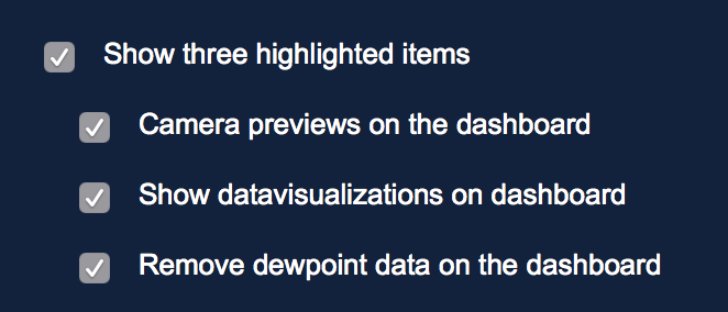

And you've enabled showing the 3 highlighted items? And it's in those 3?
step
Joined: Wednesday 01 November 2017 7:53
Re: Aurora theme
Post by step »
blauwebuis wrote: Saturday 11 August 2018 19:51 And you've enabled showing the 3 highlighted items? And it's in those 3?
Yes:
Screen Shot 2018-08-12 at 22.40.54.png (42.1 KiB) Viewed 6948 times

In the system settings, check your Dashboard Mode, it must be set in normal mode.
In the theme settings, check Show three highlighted items (must be checked) and Camera previews on the dashboard (must be checked).
