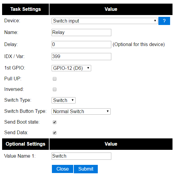

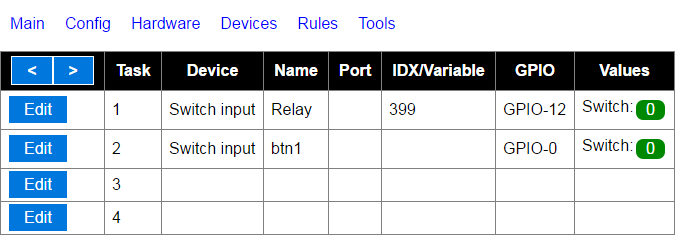

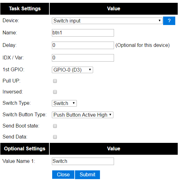

My edition of ESP easy settings for Sonoff 1ch relay below.
Works in all directions:
- pushing the button on Sonoff turns On/Off relay with LED and changing Domoticz device state.
- turning On/Off in Domoticz also turns On/Off relay with LED too.
Domoticz
On: http://esp05/control?cmd=GPIO,12,1
Off: http://esp05/control?cmd=GPIO,12,0
ESP Easy devices
31-05-2017 20-26-04.png (15.99 KiB) Viewed 5050 times
31-05-2017 20-26-15.png (27.22 KiB) Viewed 5050 times
31-05-2017 20-26-27.png (26.66 KiB) Viewed 5050 times
ESP Easy rules
on btn1#Switch do
  if [btn1#Switch]=1
    gpio,12,1
    gpio,12,0
  endif
endon
on Relay#Switch do
  if [Relay#Switch]=1
    gpio,13,0
    gpio,13,1
  endif
endon
