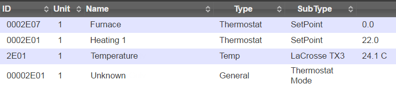

I added some code to the config, an managed to get the CO (heat) setpoint to work from domoticz.
I now have these 4 devices.
heatit devices.png (24.38 KiB) Viewed 12920 times
Heating 1 is the setpoint for CO mode. The other i presume is for COO mode.
This is showing 0dgrs, and is currently not working.

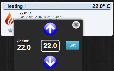

Setting temperature from web.
heatit CO setpoint.png (46.2 KiB) Viewed 12920 times

Made some more progress. Now both setpoints work, and can be adjusted from their respective devices on the web interface.
The config now creates two setpoints named "Heating" and "Energy heat". I have set them to start with temps
of 20 and 16 degrees Celsius respectively.
I still havent been able to adjust it in blockly.
