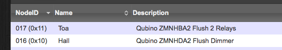

Qubino ZMNHBA2 2 relays doesn't report status?

the domoticz shipped config Config/qubino/ZMNHBA2.xml is not in sync with the upstream OZW version.
I confirm using the OZW upstream version, this device works perfectly and only two switches are recognized. (with the shipped domoticz version I have three devices and the update status doesn't works)
Gizmocuz, can you make a sync from OZW config tree? (and a binary library rebuild also if you can).
Thank you very much!

Remove the following to Config/qubino/ZMNHBA2.xml
And you'll have 3 switches. Add the script to the first switch. Works perfect here
<!-- Map endpoints to instances -->
<CommandClass id="96" mapping="endpoints" />-

I tried again tonight with removing the zwcfg file.
But i't still not 100% correct.
The problem is when I have both Q1 and Q2 turned on.
If I turn off Q1 first and then turn off Q2 it works.
However turning off Q2 first, is also turning Q1 off for a second and then they are both enabled again.
This is the code I'm running. I start it with "php refresh.php".
Am I right with the node id being 17?

?>- Attachments
- Skärmavbild 2015-09-10 kl. 21.39.06.png (24.92 KiB) Viewed 3598 times

Re: Qubino ZMNHBA2 2 relays doesn't report status?
Yes, the NodeID is the number to use.
In the first line there's a idx=5, should be the IDX of your zwave hardware.
But what with the while(1)? That's a continous loop!
There is already a loop in the function that will try 5 times to get a OK.
