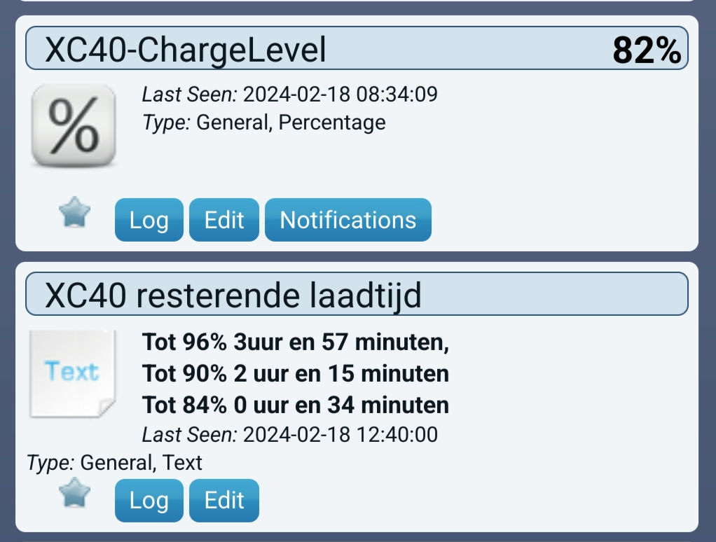

Post by HvdW »
This plugin gives lots of possibilities.
Pity that the Volvo API doesn't give the possibility yet to set charging Ampères.
Did I already say thanks @akamming for comparing this plugin?
