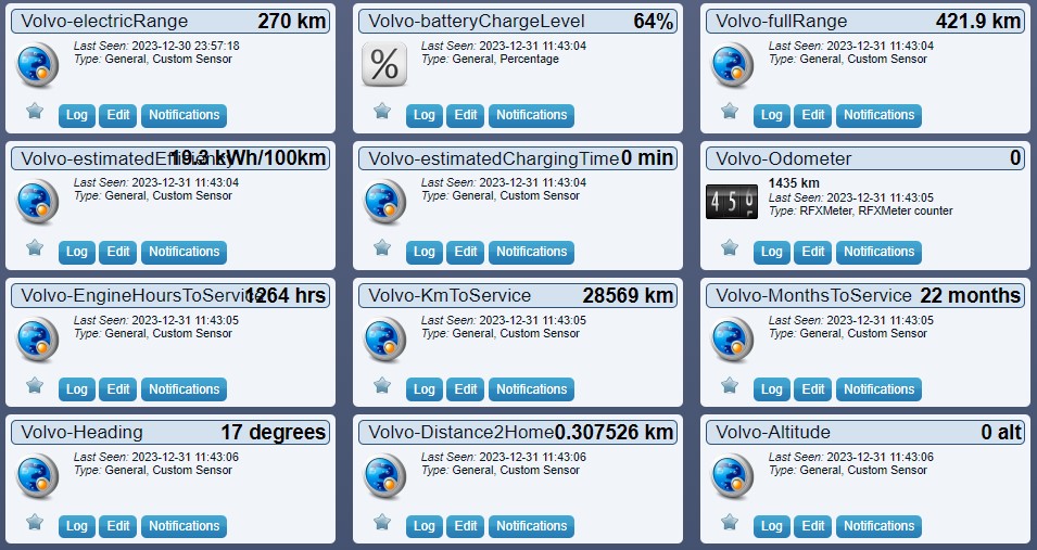

Domoticz Volvo app.jpg (171.77 KiB) Viewed 5424 times
Great!
It's all in place now.
Thanks a lot!
The display does remind me that I hope the developers will program a possibility to change the tile format to for example 2,4 6 tiles on a row and to offer the possibility to change the font size of the header.

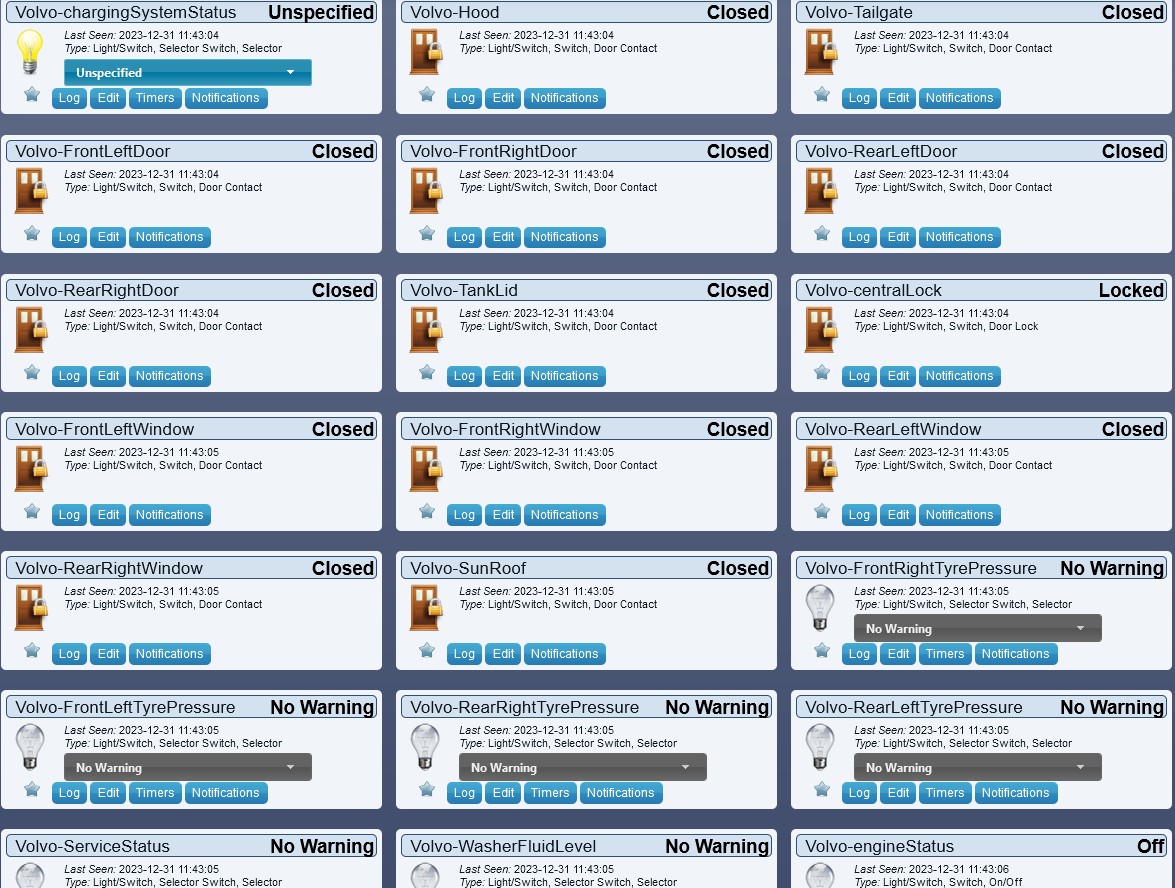

EDIT
Oops! Just discovered a lot more information.
Volvo abundant.jpg (314.51 KiB) Viewed 5407 times
Nice to have those send a notification if one of these have exceptions to report.
Bugs bug me.
