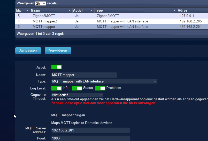

- screenshot.1.jpg (182.71 KiB) Viewed 3800 times

Re: Python Plugin: MqttMapper
Fill in the type and click on "Aanpassen"

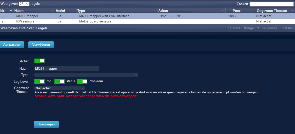

Thats what I did several times.
But the type and settings don't get saved.
So there is in hardware an item without hardware selection and without any settings.
Thats the problem.

Kedi
- Posts: 622
- Joined: Monday 20 March 2023 14:41
- Domoticz version: latest
- Location: Somewhere in NL
Did you try to delete the hardware and create it again?
And is the file mqttmapper.json present and valid?
I think you found a bug!
If you put a other plugin in the plugin folder that uses DomoticzEX framework the value of Type: of the Mapper plugin is visible.
So a dirty fix is:
You don't have to use the plugin as you see the plugin works.
Ps. the beta latest build 15372 has also the issue.
So a dirty fix is:
cd ~/domoticz/plugin
git clone https://github.com/stas-demydiuk/domoticz-zigbee2mqtt-plugin.git
sudo systemctl restart domoticz.servicePs. the beta latest build 15372 has also the issue.
Thanks for your answer.
The "dirty trick" works!
But when I upgraded Bulseye afterwards the upgrade complete broke Domoticz.
Domoticz can't open port 8080 anymore. Other problem. Not this topic
So I decided to go back to Buster.
Fresh install and complete upgrade.
However i found that I still had to do the "dirty trick" to see hardware type and settings of the plugin.
So: maybe not Bulseye then. Domoticz stable without problems on Buster now.
See attachement:
Also as you see: adding extra folder wit second version of plugin (rename plugin key in plugin.py) adds the possibility to connect to second broker.
Nice!
Hope this will help ..
Willem
See attachement:
Nice!
Willem

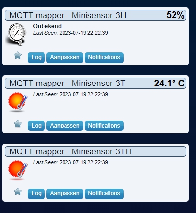

Still playing around with this plugin.
version 1.0.13 Got some created devices working in DZ. But:
Found a problem. Or maybe I'am doing things wrong.
It has to do with a payload in JSON format and using 2 values from that in one device ...
See part of JSON-file
Working:
"Minisensor-1H": {
"topic": "home/OpenMQTTGateway_ESP32_BLE/BTtoMQTT/A4C1384BF6E8",
"type": "81", "subtype": "1", "switchtype": "0",
"mapping": {"item": "hum"}
Working also:
"Minisensor-1T": {
"key": "Minisensor-1T",
"type": "80", "subtype": "5", "switchtype": "0",
"mapping": {"item": "tempc"}
Not working (device is created but never receives any data):
"key": "Minisensor-1TH",
"type": "82", "subtype": "1", "switchtype": "0",
"mapping": {"item": "tempc;hum"}
key's used because it's one topic for all three devices.
That works OK!
Any idea?

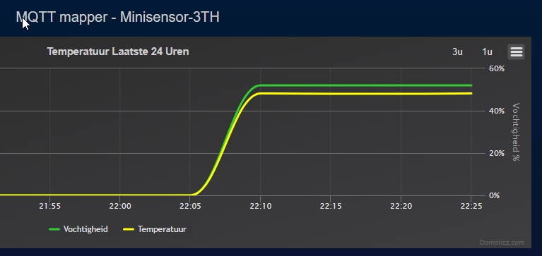

I have to correct. The device icon doesn't show data. But the device log does!
Strange.
Willem
