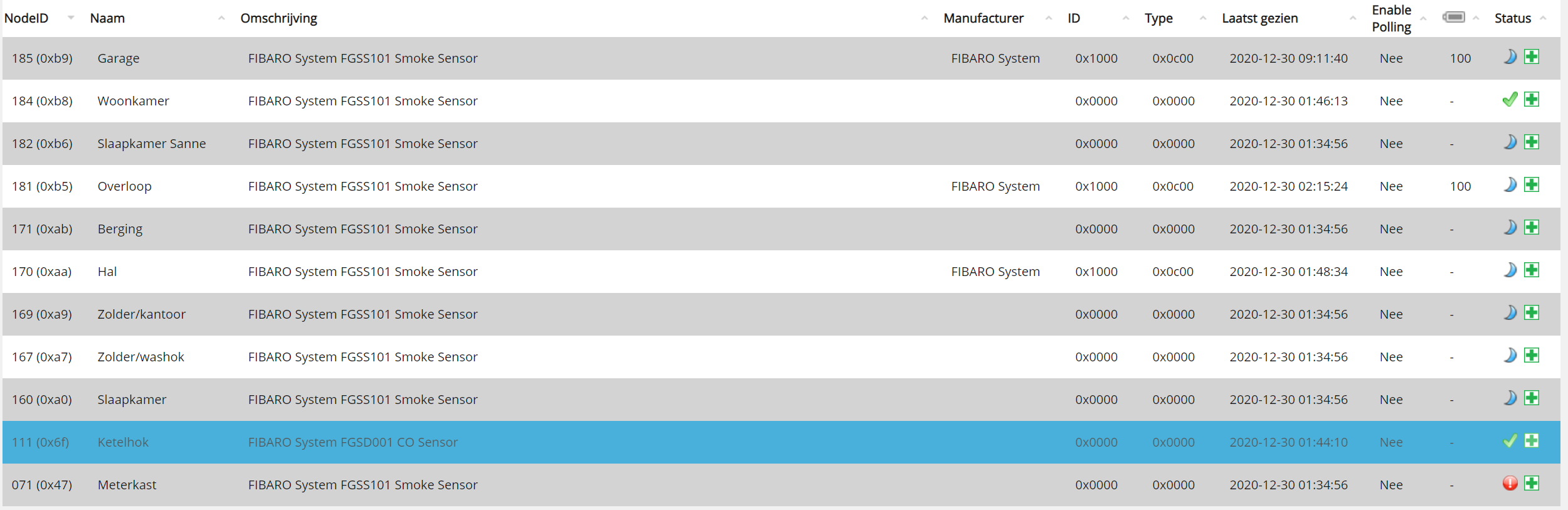

I had already drafted a first response, but I've been so busy re-including devices that I didn't find the time to put it here...
23-12-2020
Thanks for the responses! Good to see, that it is not only my installation that has this.... So, before responding to the individual responses, I'd like to outline how I am trouble shooting things now.
I am gradually adding all devices again. And adding now means:
By this time, I have done this for 26 devices. However, I must point out, that three of those were added before removing the Greenwave single power nodes from my network.
In general it would have been really nice if you could appoint a node ID (the 0xsomething-something number) yourself. Then I would make sure only stuff like a1, a2 etc is used as those can be found much more easily in the devices list. If you have a number lik 53....you know how often that occurs?!?
Well, let's have a look! I am not going to point out the devices that are still working fine.... it is "trouble" shooting after all
Basically, some devices in the attic are not responding, so it seems out of reach. However, I was able to reconnect the GreenWave Reality Inc PowerNode 6 port while it was in the attic. After adding it just get out of reach. And the strange thing is, that the Coolcam powernode that is working properly is pretty close, so that should act as a hub.
I think I do recall that these devices were not too happy when communicating not directly to the controller.

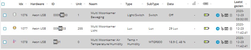

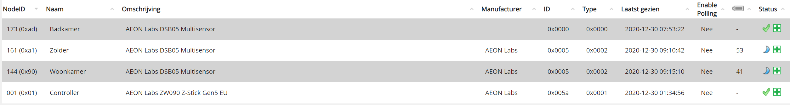

Let's focus on an Aeotec Multisensor that I am using in the living room.
This is the last entry in the logging of the movement sensor:
2020-12-23 01:35:30 On

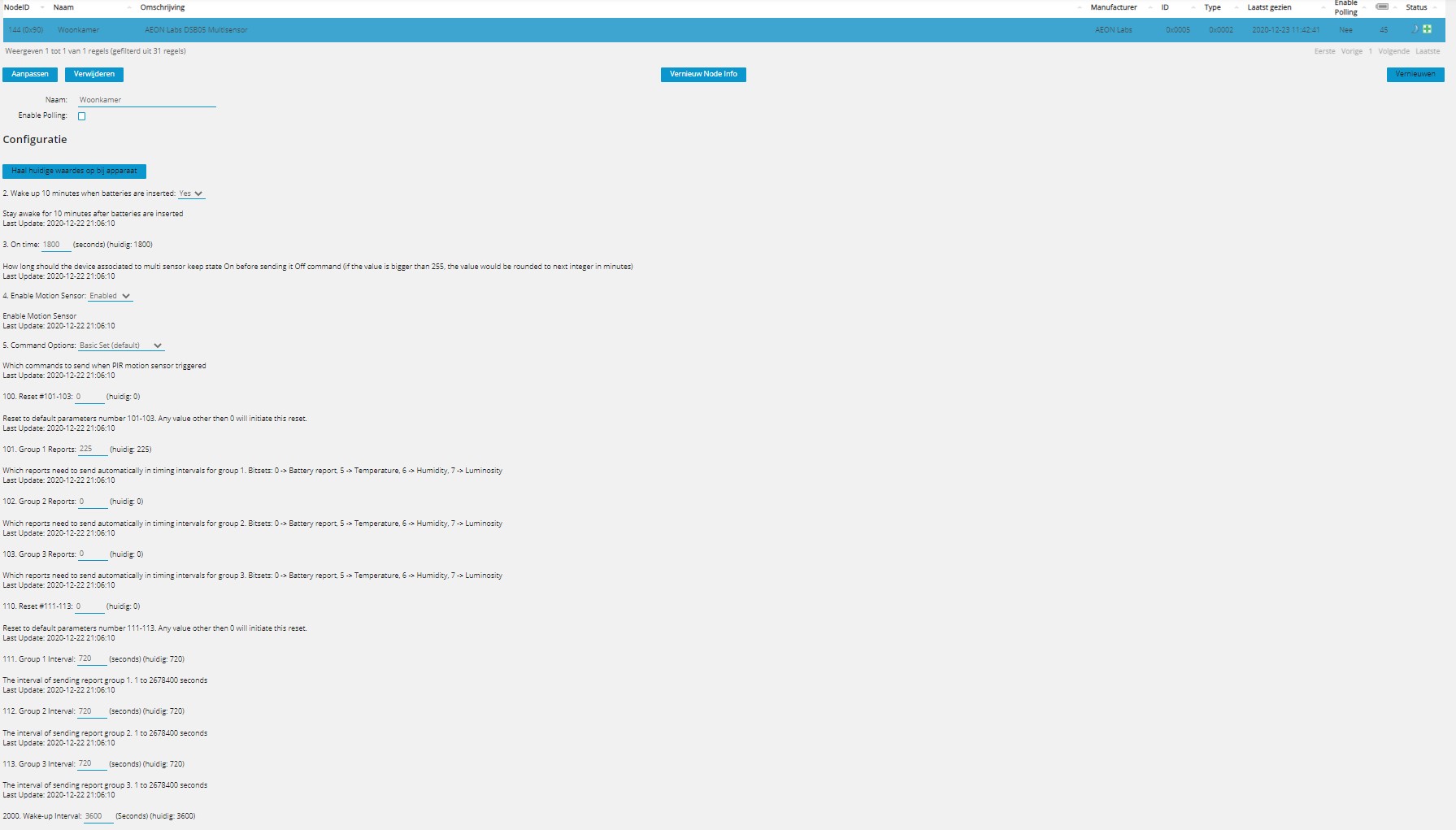

I do see the movement in the room being noticed as the LED on the sensor blinks. Now please have a look at the following screen shots: It shows the node was last seen on 2020-12-23 at 11:42:41
Motion sensor is enabled and reporting is set to 225 and an interval of 720 seconds
Strange enough the motion has last been seen 2020-12-23 at 03:32:00 whereas other sensors (light and temperature/humidity have been last seen more recently)
And this is what I see happening all the time! The node has been seen recently, but one or more devices beneath it not. And the only way to "revive" it is by removing and re-adding.
In this case I tried the following:
In the OZW CP there is some logging as well, but most of it, I don't understand. Does anyone here understand it?

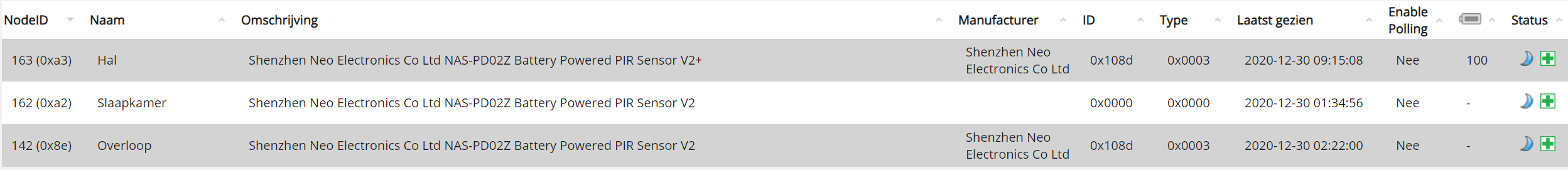

- Overloop, Coolcam multi sensor: Had to replace the battery and somewhere in the past days all parameters had been reset to defaults.

All smoke sensors that have "Manufacturer" "FIBARO System" have set the parameters to default
All smoke sensors that have "Manufacturer" null have no parameters at all.
The same goes for the Coolcam multi sensors
And for the Aeon multi sensors What causes this? Why are the parameters set to default?
Today I have updated to version 2020.2.12825 because I read that things should have been improved on the Z-Wave side. So, I am really looking forward to some improvement! I understand I need to re-include the nodes once more...let's try that.
As I understand here and there some people do not experience issues with Z-Wave. I am really curious as to what I am doing different!
