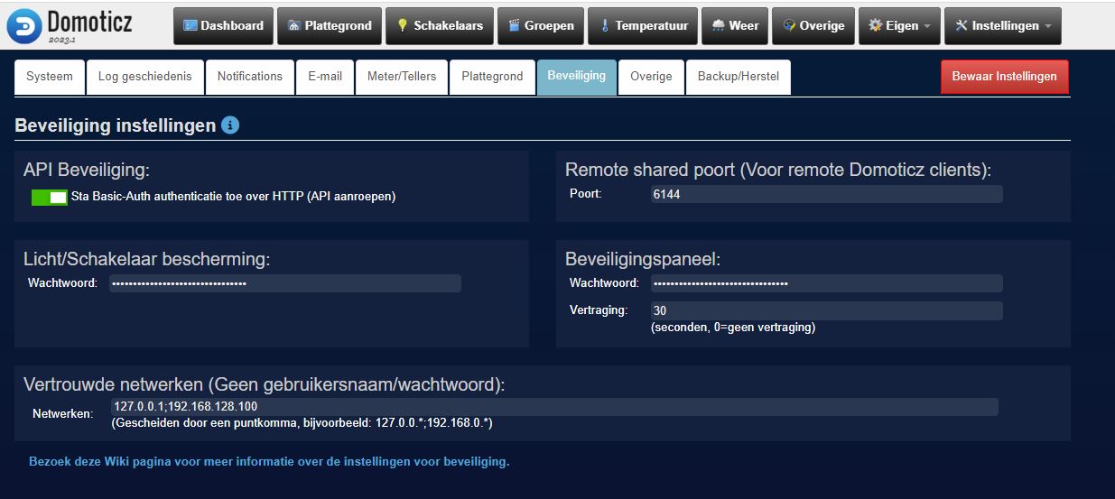

I think this is what I have read about in other threads: not sure about the details but I think you need to go into the settings page in Domoticz, open the 'Security' tab, and there enter both 127.0.0.1;192.168.x.y, where x and y are the digits for the internal ip address of your domoticz. I used to have .* in there, as is suggested in the comments, but I read somewhere that this no longer works.. Give it a try.
I also enabled 'Allow Basic Auth authentication over HTTP (API calls)', but I'm not sure that is actually needed.
My own problem seems to be something else though. I'm guessing the firmware in my envoy got updated? Or is it the software in Domoticz that has changed?

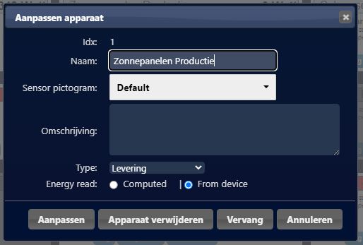

Can you edit the device and set it to generated?

@benedict & @JustDude:
Because a picture sometimes says more than a 1000 words: I think gizmocuz asks you to go to the device and press it's 'Aanpassen' button to open this screen:
Then change the value after "Type:" to "Levering" for the solar production (if it's not like that yet), and to "Verbruik" for the both other devices. If your device's properties page does not show this option, please close all of your browser windows and refresh your browser cache. And then try again.

Bummer, I noticed that I used another Enphase plugin (Enphase with micro inverters) and not the one in the list.
Now I can change the return and usage options.

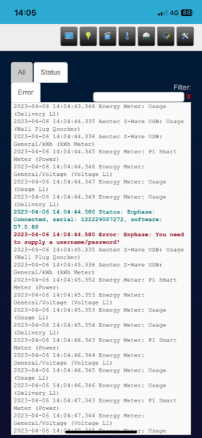

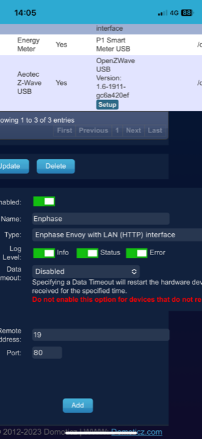

I am trying to connect my Envoy but in the logfile it sas that i have to supply username/password.
I do not get this option in the hardware settings menu.
I have the latest version of domoticz installed.
what am i doing wrong?
Posts: 7010
Domoticz version: 2026.3
Re: enphase envoy with (HTTP) interface
Clear your browser cache! The user/password values should be there!

waltervl wrote: Thursday 06 April 2023 23:50 Clear your browser cache! The user/password values should be there!
Perfect..its working now..thank you
