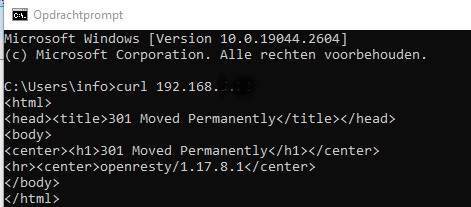

I also have the same problem
Enphase is recognized by id nr and software version but i can't get data into domoticz
praet mar frysk
brugje
Joined: Monday 13 February 2023 19:36
Domoticz version: 2024.4
Location: NL (Echtenerbrug)
Re: enphase envoy with (HTTP) interface
Post by brugje »
When i do a curl on my envoy Ip i get.
Is there somebody with a solution.
groet Jan
praet mar frysk
