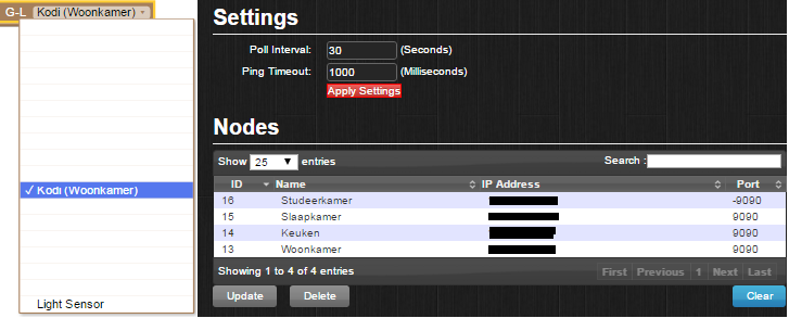

My Kodi Settings. Strange thing is... Only 'Woonkamer shows up in Blockly,
My Kodi Settings
My Kodi Settings

My first thought is that in the hardware page your device is called 'Studeerkamer' but in your Lua you have called it 'Studeerkamer Kodi'. Can you change that and retry?
I will have a look at the Pause in the next day or so.

A maybe I was mistaken by the screenshots mentioned here in the wiki: https://www.domoticz.com/wiki/Kodi
it say "Lounge" in the setup screenshot and in the end it says "Lounge Kodi" :D

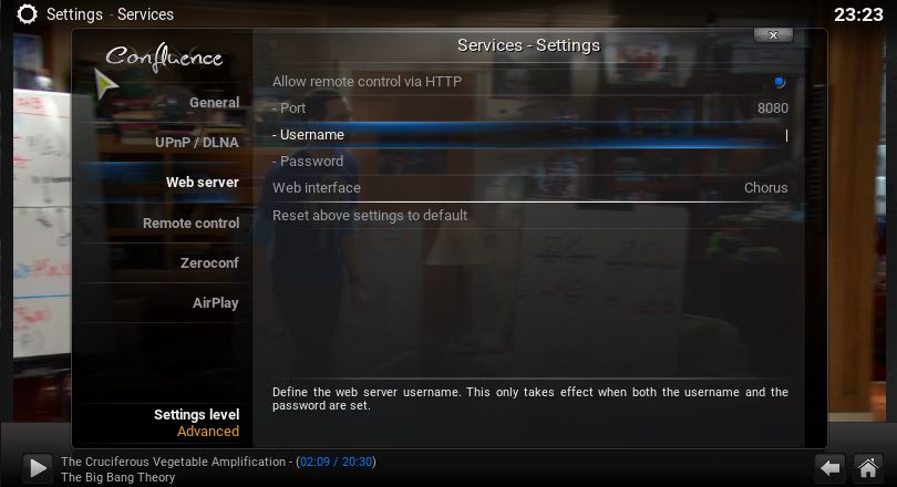

If I do the following:
System -> Settings -> Services -> Web Server, I have username & password empty as described and port 9090.
If I disable the Allow remote control via HTTP en re-enable it and type 9090 again. The domoticz log changes instantly.

Well. The situation
Windows 10 machine with KODI (15.2)
Resumed from sleep.
Kodi: (Studeerkamer) Sending data: '{"jsonrpc":"2.0","method":"Input.ExecuteAction","params":{"action":"pause"},"id":1006}'
Kodi: (Studeerkamer) Sent command: 'Input.ExecuteAction pause'.
Kodi: (Studeerkamer) Sending data: '{"jsonrpc":"2.0","method":"Addons.ExecuteAddon","params":{"addonid":"script.securitycam"},"id":1010}'
Kodi: (Studeerkamer) Sent command: 'Execute Addon script.securitycam'.
However nothing happens.
- disable the Allow remote control via HTTP
The domoticz log does indeed changes instantly.
2015-12-22 18:25:48.631 Kodi: (Studeerkamer) Event: 'Off'.
2015-12-22 18:25:49.127 Kodi: (Studeerkamer) Sending data: '{"jsonrpc":"2.0","method":"System.GetProperties","params":{"properties":["canhibernate","cansuspend","canshutdown"]},"id":1007}'
2015-12-22 18:25:49.130 Kodi: (Studeerkamer) Handling message: '{"id":1007,"jsonrpc":"2.0","result":{"canhibernate":true,"canshutdown":true,"cansuspend":true}}'.
2015-12-22 18:25:49.130 Kodi: (Studeerkamer) Sending data: '{"jsonrpc":"2.0","method":"Player.GetActivePlayers","id":1005}'
2015-12-22 18:25:49.132 Kodi: (Studeerkamer) Handling message: '{"id":1005,"jsonrpc":"2.0","result":[{"playerid":1,"type":"video"}]}'.
2015-12-22 18:25:49.132 Kodi: (Studeerkamer) Sending data: '{"jsonrpc":"2.0","method":"Player.GetItem","id":1003,"params":{"playerid":1,"properties":["artist","album","year","channel","showtitle","season","episode","title"]}}'
2015-12-22 18:25:49.204 Kodi: (Studeerkamer) Handling message: '{"id":1003,"jsonrpc":"2.0","result":{"item":{"album":"","artist":[],"episode":3,"id":7728,"label":"The Fuzzy Boots Corollary","season":1,"showtitle":"The Big Bang Theory","title":"The Fuzzy Boots Corollary","type":"episode","year":0}}}'.
2015-12-22 18:25:49.204 Kodi: (Studeerkamer) Sending data: '{"jsonrpc":"2.0","method":"Player.GetProperties","id":1002,"params":{"playerid":1,"properties":["live","percentage","speed"]}}'
2015-12-22 18:25:49.205 Kodi: (Studeerkamer) Handling message: '{"id":1002,"jsonrpc":"2.0","result":{"live":false,"percentage":65.3211669921875,"speed":1}}'.
2015-12-22 18:25:49.212 Kodi: (Studeerkamer) Event: 'Video - The Big Bang Theory [S1E3], The Fuzzy Boots Corollary'.
2015-12-22 18:25:50.128 Kodi: (Studeerkamer) Sending data: '{"jsonrpc":"2.0","method":"Player.GetProperties","id":1002,"params":{"playerid":1,"properties":["live","percentage","speed"]}}'
2015-12-22 18:25:50.129 Kodi: (Studeerkamer) Handling message: '{"id":1002,"jsonrpc":"2.0","result":{"live":false,"percentage":65.398414611816406,"speed":1}}'.
And the commands
commandArray['Studeerkamer']='Pause'
or
commandArray['Studeerkamer']='Execute script.securitycam'
are working! :D

I think I found it.
Changed Allow remote control via HTTP Port to 8080 (no uid+pwd)
I issued
C:\>netstat -an |find /i "listening"
As a result now not a double 9090 but 2 ports open.
TCP    0.0.0.0:8080
TCP    0.0.0.0:9090
TCP    [::]:8080
TCP    [::]:9090
And everything is working just fine. :D :D
Webserver Kodi at port 8080
Kodi Webserver Port 8080.JPG (52.65 KiB) Viewed 4439 times
