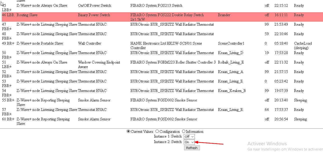

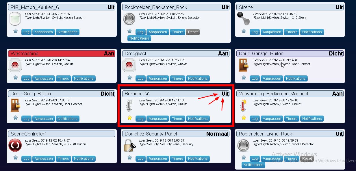

Hi mate, i think there is something else going on in my zwave network.
I don't know what it is exactly, but some of the temperatures of other devices are not reporting now also (fibaro motion sensor, fibaro door sensors)
What im having right now: i'm in the 'living' (sorry, dont know the english word lol)
and its veryyy hot in here.
If i check the status of my 'brander' in domoticz, it is off
when i check the openzwave panel, there it is on and if i check at the brander hardware itself, it is indeed running.
that explains the heat in my living.
I don't know why domoticz isn't updating properly.
Is it domoticz? is it zwave? is it my raspberry pi 3b+ ?
you can see it at the added pictures.
I will need to solve this, because i need to trust on this system it is working properly.
For the same money, i'm sleeping and my brander is working the whole night .....
