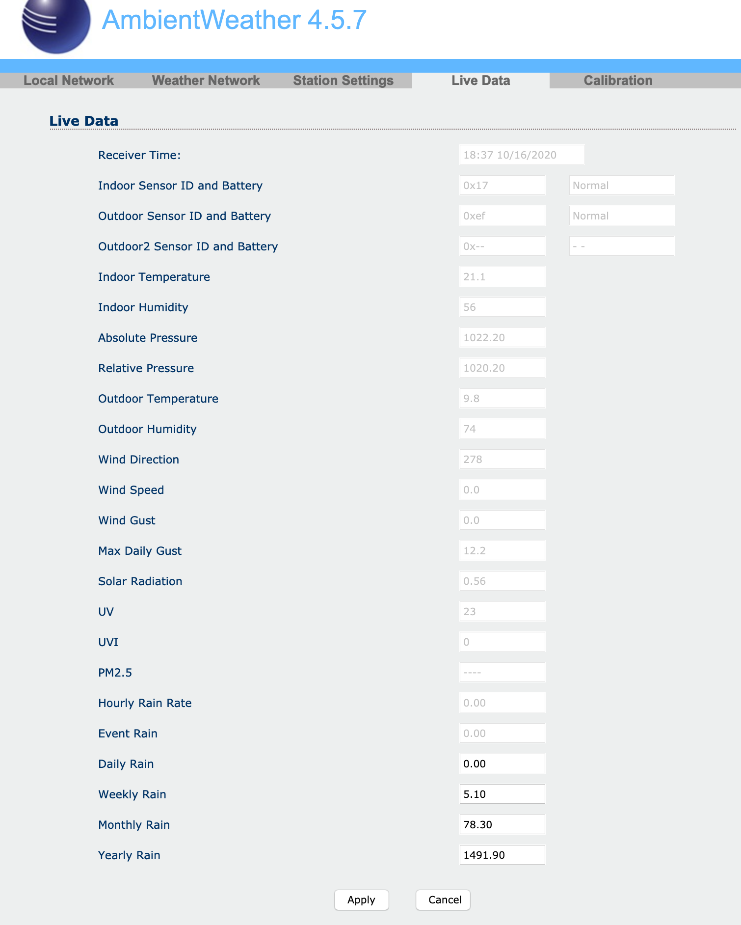

Thank Xorfor!!!Xorfor wrote: Thursday 15 October 2020 22:19 @atlantic: I made a quick fix. Hopefully this prevents the errors in your log.
The data is importing now; only 3 records are still empty:
