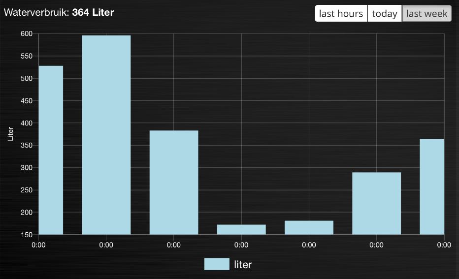

And this is the result:
Do you know how to adjust the x-values of the last week graph? It now shows 0:00

I adjusted the x-files but in the week graph is still shows 0:00. This is the same at the water usage graph and also at the power usage graph. By all the other graphs is is possible to adjust the x-values. I use range: month, filter 1 week.

You can change the time-format on the x-axis with the displayFormats setting. like:
blocks['graph_903'] = {
    graph: 'bar',
    datasetColors: ['lightblue'],
    legend: true,
    custom : {
        "last hours": {
            range: 'day',
            filter: '6 hours',
            data: {
                liter: 'd.v*100'            }
 	"today": {
            range: 'day',
            filter: '12 hours',
            data: {
                liter: 'd.v*100'            }
	"last week": {
            range: 'month',
            filter: '7 days',
            data: {
                liter: 'd.v*1000'            }
            displayFormats: {
                'hour': 'D MMM',
The range 'month' provides only one measurement per day. I cannot change that: it's controlled by Domoticz.
Since you filter 'just' 7 days, the chart.js module uses the 'hour' format. The default format for the hour format is 'H:mm'. That explains the '00:00' you see. By setting it to 'D MMM' you get the day/month label.
What I will do is modifying the default hour format to 'D MMM' in case the 'month' range is selected. For a month range is doesn't make sense to add the hour information, since we only get one measurement per day anyway,

Thnk you again, it is working now :-). I already tried some settings but did not use this one :-)

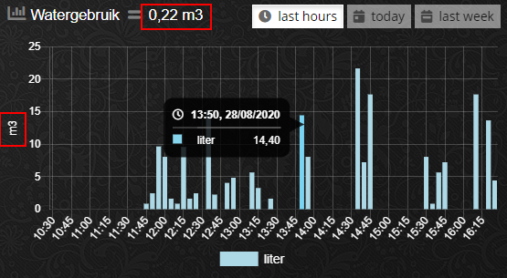

JacKok
Posts: 11
Joined: Friday 08 February 2019 21:27
Domoticz version: V4.10717
Re: [Experimental] New graph module. Testers needed.
Post by JacKok »
i got it working too, but the graph shows M3 instead of liters
Can this also be adjusted?
it is displayed correctly in Domoticz
