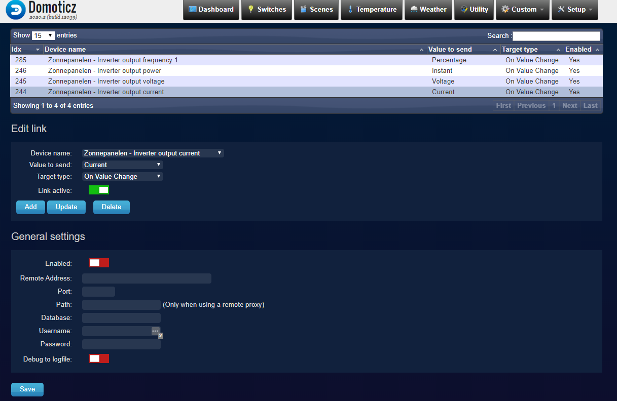

@wiljums,
As far as I can see, I don't think it is an issue with the plugin but with the datapush system. I googled a bit and found some topics on tweakers (guess you're Dutch too): Tweakers and I found this topic deep down in Domoticz forum: Current (ampere) does not push to InfluxDB
Further, I tried adding the 'current' devices to the Influxx data push but did not run into errors (I do not actually push as I do not have anything setup so that may be the difference):
datapush configure.png (65.05 KiB) Viewed 2792 times
Do you push current values from other data sources as well? If so, are there any differences to the data structure?
