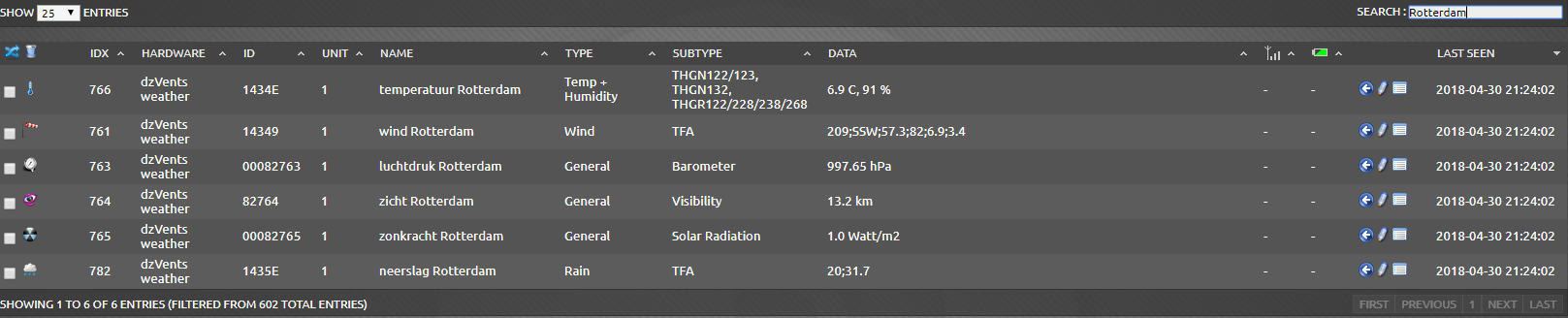

Re: updateWeatherSensors (yet another buienradar script)
It might be an idea to separate the "Wind+Temp+Chill" device in 2 devices "Wind" and "Chill Temp"
The "Wind+Temp+Chill" is also separated in 2 devices but those have the same name.
So if I call it "Wind" then that device is present on the Temperature an Weather tab with the same name.
Just an idea.
Just an idea.
- waaren
- Posts: 6028
Hi EddyG,
not quite sure what you propose. The "wind" device is already shown on both the temperature and the weather tab. If I mis-interpret your suggestion please let me know.
- Device screen filtered on text Rotetrdam
- devicesScreen.PNG (102.44 KiB) Viewed 3816 times
