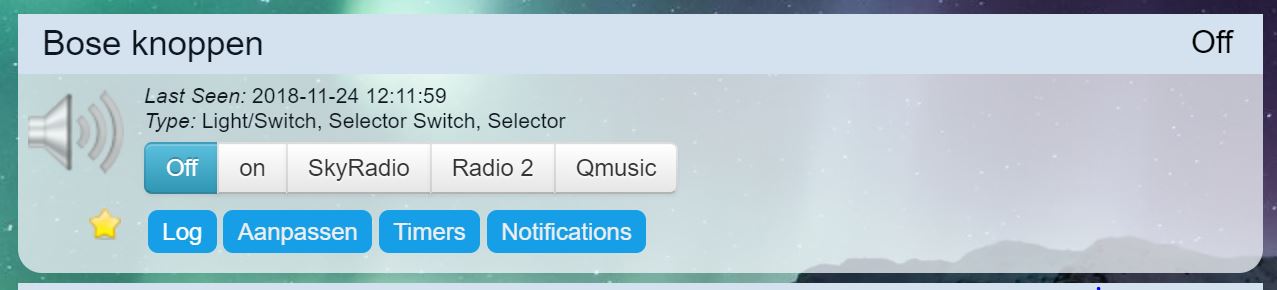

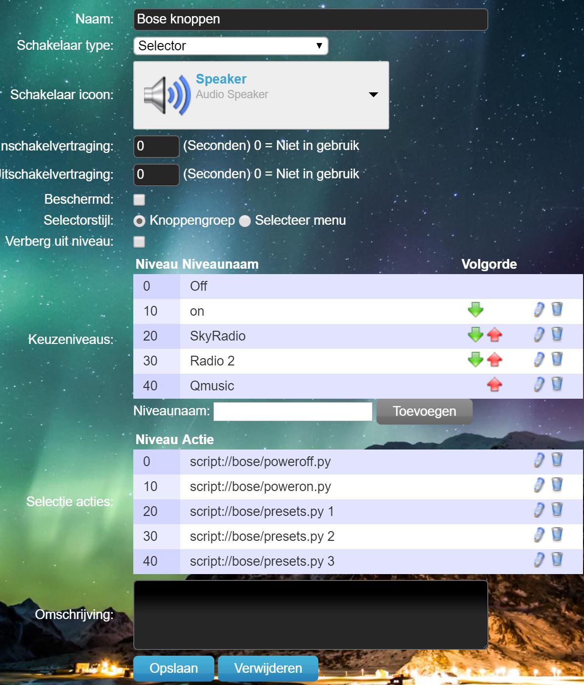

In domoticz go to settings ->hardware
add Dummy hardware
create virtual swith (selector)
go to devices and make sure that the device is added to switches
edit the switch
Make sure you add something like this (depents on your situation)
bose knoppen.JPG (200.9 KiB) Viewed 3326 times
If add something like this then you are able to select the presets like this.
