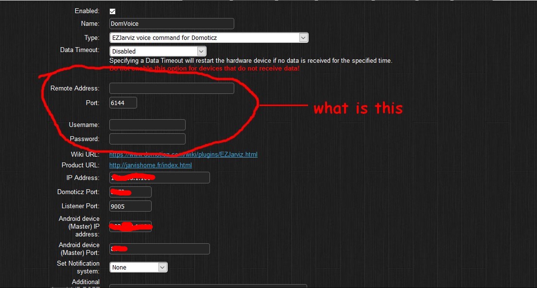

My errors:
 2019-02-23 19:49:37.849 (DomVoice) Initialized version 1.0.0, author 'zak45'
2019-02-23 19:49:37.874 (DomVoice) lang file : /home/domoticz/plugins/EZJarviz/en_en.lng
2019-02-23 19:49:37.874 Error: (DomVoice) Traceback (most recent call last):
File "/home/domoticz/plugins/EZJarviz/plugin.py", line 968, in loadLang
with open(lang_file, 'r' , encoding='utf-8') as fp:
FileNotFoundError: [Errno 2] No such file or directory: '/home/domoticz/plugins/EZJarviz/en_en.lng'
2019-02-23 19:49:37.874 Error: (DomVoice) __Lang file not exist or to process data from : /home/domoticz/plugins/EZJarviz/en_en.lng__
2019-02-23 19:49:37.874 Error: (DomVoice) __Language file is missing for : en__
2019-02-23 19:49:37.875 Error: (DomVoice) 'onStart' failed 'AttributeError':''module' object has no attribute 'Connection''.
2019-02-23 19:49:37.875 Error: (DomVoice) ----> Line 205 in /home/domoticz/plugins/EZJarviz/plugin.py, function onStart
configurations are different
my config.jpg (127.13 KiB) Viewed 3064 times
zak45
Posts: 954
Domoticz version: V2024.4
Re: Vocal command for Domoticz
Post by zak45 »
you need to take the one on the lng folder.
kniazio
Posts: 204
Joined: Thursday 06 October 2016 8:14
Domoticz version: 3.7243
Post by kniazio »
there is no en_en.lng file in the lng folder
Which means:
 2019-02-23 23:17:24.292 Error: (DomVoice) 'onStart' failed 'AttributeError':''module' object has no attribute 'Connection''.
2019-02-23 23:17:24.292 Error: (DomVoice) ----> Line 205 in /home/domoticz/plugins/EZJarviz/plugin.py, function onStart
what is this
my config.jpg (127.13 KiB) Viewed 3052 times

zak45
Posts: 954
Post by zak45 »
kniazio wrote: Saturday 23 February 2019 23:27 I do not understand how it works
All is on the dropbox.
If you do not have enough python knowledge, not simple.
And without any documentation, not easy.
Maybe better for you to wait for the WiKi.
