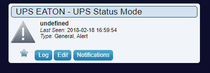

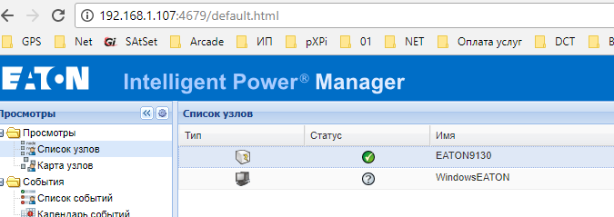

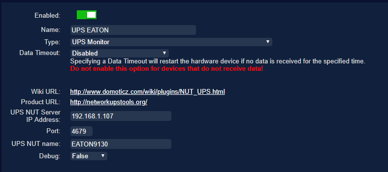

Help needed with EATON 9130 running on Windows 10:
EATON 9130
ip of Windows server : 192.168.1.107
port: 4679
Usp name in EATON Intelligent Power Manager: EATON9130
error:
2018-02-18 16:57:52.553 Error: (UPS EATON) Error reading UPS variables: HTTP/1.0 501 Not Implemented
2018-02-18 16:58:44.241 Error: (UPS EATON) Error reading UPS variables: HTTP/1.0 501 Not Implemented
2018-02-18 17:00:09.587 Error: (UPS EATON) Error reading UPS variables: HTTP/1.0 501 Not Implemented
2018-02-18 17:01:18.703 Error: (UPS EATON) Error reading UPS variables: HTTP/1.0 501 Not Implemented
2018-02-18 17:02:18.751 Error: (UPS EATON) Error reading UPS variables: HTTP/1.0 501 Not Implemented
Anybody with NUT on Windows Intelligent Power Manager?
Thank you!
eaton 3.PNG (18.07 KiB) Viewed 5271 times

Velly wrote: Sunday 18 February 2018 15:05 2018-02-18 16:57:52.553 Error: (UPS EATON) Error reading UPS variables: HTTP/1.0 501 Not Implemented
@Velly, looks like you are configuring the plugin to hit a http webserver (the Eaton intelligent power manager) rather than a NUT server... first make sure you have a NUT server up and running and adjust to the right IP/Port

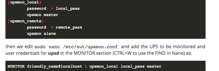

Hello, thanks for the plugins :D . I have a little worry with nut, my ups is directly plugged into my raspberry and the server nut is also on the raspberry. my problem is that i can not disable user / password access.
do you have an idea of ​​how?

@copernicnic, authentication is not yet handled by the plugin. Not difficult to implement, bear with me for a few days and I’ll send you by pm a new version for testing.

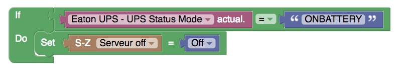

hello, everything is ok now :D :D , just wait a moment that domoticz update the device.
do you know what value to put in the event to make interact?
screenshot 2018-04-27 à 10.54.41 1.jpg (34.77 KiB) Viewed 4801 times
Thank you very much for your work

@Logread,
I just tested the plugin you sent me, it does not work unfortunately. here is the log
The attachment screenshot 2018-04-27 à 11.28.57.jpg is no longer available
I just saw in the command that there is a story of master and slave
screenshot 2018-04-27 à 11.31.21.jpg (49.13 KiB) Viewed 4797 times
screenshot 2018-04-27 à 11.28.57.jpg (38.82 KiB) Viewed 4799 times

@copernicnic, let’s debug this by private message rather than posting on the public thread, to avoid clogging it... in my last pm, I told you that the edits were not tested... since my own setup does not require a login. Let me do some investigations in the network ups tools code and docs but this will not be before several days.
In the meantime, if you have the knowledge to do this, please try to login from shell with a telnet session and post me the result by pm, not on the forum thread pls.
