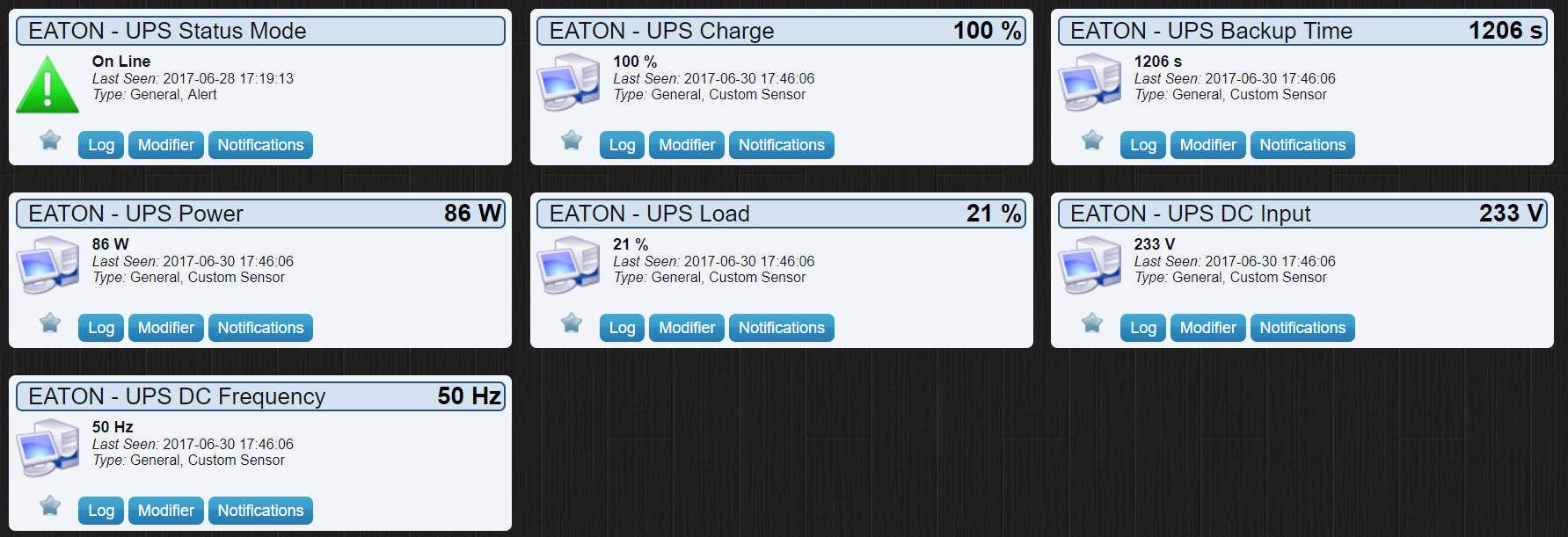

Another python plugin that I wrote that I am releasing in case anyone finds it useful.
It exposes via Domoticz devices a number of status variables reported by compatible UPS (Uninterruptible Power Supply) units via a NUT (Network UPS Tools) server running on the same local network as the Domoticz system. An example could be a UPS compatible with a Synology NAS and connected to it with UPS management enabled on the Synology NAS (this is my personal setup: a EATON Ellipse PRO 650 UPS connected to a Synology NAS via USB, with the UPS driving a router, a wifi A/P, the NAS and a Raspberry hosting domoticz).
The plugin is written so as to avoid the need to install any client side software or "packet" such as the NUT Client. It fetches the UPS data directly from the NUT Server via a telnet session, updated every minute (hence any change in the UPS status such as switching to backup power may take up to one minute to be reflected. This is a compromise setting to avoid undue network traffic)
This plugin allows the monitoring/logging of the following UPS variables:
  • "ups.status": displayed as alert device "UPS Status" - the status of the UPS (Green = On Line, Red = Backup power)
    "battery.charge": displayed as device "UPS Charge" - the % charge of the UPS battery
    "battery.runtime": displayed as device "UPS Backup Time" - estimated time on backup power before the UPS dies
    "input.voltage": displayed as device "UPS DC Input" - the voltage of the DC mains input
    "ups.load": displayed as "UPS Load" - the load output in % of max power of the UPS
    "ups.realpower": displayed as "UPS Power" - effective power in watts of the UPS load
    "input.frequency": displayed as device "UPS DC Frequency" - the frequency of the DC mains input
Only the "UPS Status" device is always created by the plugin, others are created if the specific UPS reports the variable. Here is a screenshot with all these devices:
If you want to know more and for installation instructions, see the wiki at https://www.domoticz.com/wiki/Plugins/NUT_UPS.html

2017-08-28 18:55:38.560  (MyUps) Variable UPS Power = None
2017-08-28 18:55:38.560  (MyUps) Variable UPS Charge = 100
2017-08-28 18:55:38.560  (MyUps - UPS Charge) Updating device from 0:'100' to have values 0:'100'.
2017-08-28 18:55:38.564  (MyUps) Variable UPS AC Input = 236.0
2017-08-28 18:55:38.564  (MyUps - UPS AC Input) Updating device from 0:'236.0' to have values 0:'236.0'.
2017-08-28 18:55:38.568  (MyUps) Variable UPS Status = OL
2017-08-28 18:55:38.568  (MyUps) Variable UPS AC Frequency = None
2017-08-28 18:55:38.568  (MyUps) Variable UPS Load = 8
2017-08-28 18:55:38.568  (MyUps - UPS Load) Updating device from 0:'8' to have values 0:'8'.
2017-08-28 18:55:38.577  (MyUps) Variable UPS Backup Time = 450
2017-08-28 18:55:38.577  (MyUps - UPS Backup Time) Updating device from 0:'450' to have values 0:'450'.

TiXav wrote: Monday 28 August 2017 19:27 I have installed this plugin for 3 days, but I must deactivated it because domoticz crashs.
Before crashes, all devices are well updated by the plugin for 1h or 3h or 6h (max) then suddenly it crash.
There are apparently some issues with python plugins in recent beta versions of domoticz (python plugins have even been deactivated in latest betas since a couple of days, pending a fix possibly). Which version are you using ?

Ok, understood, you are right I saw some thing about that but I did not make the link in mind. I run 3.8364.
So I look forward a patch patiently
Thank you
