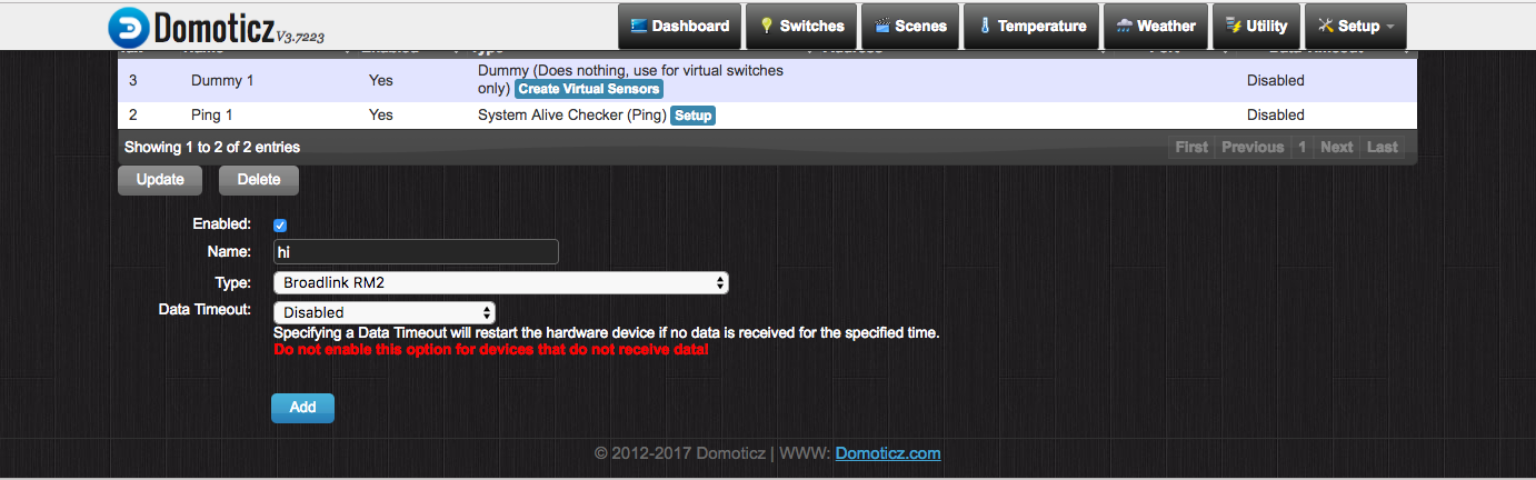

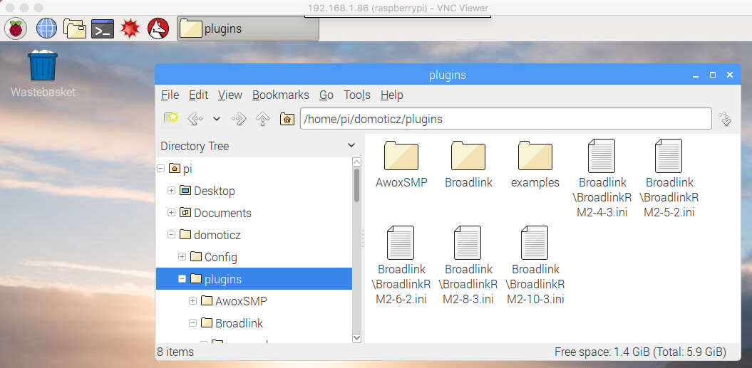

I realize I was running 3.5 and I've upgraded to 3.7. In Domoticz folder I see a folder plugins and there are some examples plugins in it. So I created a new folder labeled Broadlink with plugin.py in the folder. So.... /home/pi/domoticz/plugins/Broadlink
I finished off with a sudo reboot, I now see Broadlink RM2 show up in Hardware but there no Param field. I've included a screenshot for your view. My guess is the plugin not launching or it could be something else due to Phyton 3?

the learn process is the same for RF/IR
on param "Folder to store ini files" just replace \ by / everywhere
if you read the wiki, there is a way to auto discover Broadlink RM2 device and display IP address & mac in Domoticz log

Found the problem to "ini" the ID labeling has to be right on the switches or it will get confused.
As for INT
Error
Filter:
X
2017-04-02 17:36:10.986 Error: (TEST 109) ini file not found: everywhere\BroadlinkRM2-14-1.ini
2017-04-02 17:36:12.589 Error: (TEST 109) ini file not found: everywhere\BroadlinkRM2-14-1.ini
2017-04-02 17:36:13.691 Error: (TEST 109) ini file not found: everywhere\BroadlinkRM2-14-1.ini
2017-04-02 17:36:14.493 Error: (TEST 109) ini file not found: everywhere\BroadlinkRM2-14-1.ini
2017-04-02 17:36:14.845 Error: (TEST 109) ini file not found: everywhere\BroadlinkRM2-14-1.ini
2017-04-02 17:39:28.189 Error: (TEST 110) ini file not found: /everywhere\BroadlinkRM2-15-1.ini
2017-04-02 17:39:30.243 Error: (TEST 110) ini file not found: /everywhere\BroadlinkRM2-15-1.ini
2017-04-02 17:39:31.996 Error: (TEST 110) ini file not found: /everywhere\BroadlinkRM2-15-1.ini
2017-04-02 17:40:07.556 Error: (TEST 110) ini file not found: /everywhere\BroadlinkRM2-15-1.ini

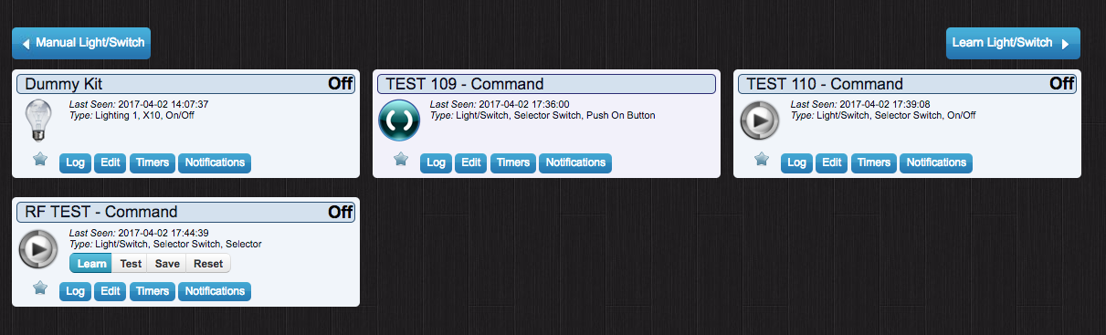

... still can't get RF to Learn though but IR, Learns fine.
Screen Shot 2017-04-03 at 1.54.50 AM.png (189.3 KiB) Viewed 4370 times
Screen Shot 2017-04-03 at 1.46.37 AM.png (163.4 KiB) Viewed 4372 times

@jlites00
Try it! (/)
  /home/pi/domoticz/plugins/Broadlink/
Before that delete old ini

Just an update. Following @andi216 & @zak45 tip on "Folder to store ini files" directory, they both worked as copied below with no Errors.
/everywhere
or
