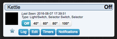

I've updated the script in the first post of this thread, fixed a few things:
1) Script would freeze after about 3 - 6 hours, now it loops the entire connection so as not to do that.
2) Implemented work-around for reliability issue with my kettle in detecting if it is on or off base using the temperature 127 if it's off base to determine the on / off base status (instead of the 07 / 08 which I found to be unreliable).
3) Implemented 4 temperature selection options via command line variables
Starting to think we need a nice web interface or something for the kettle AND coffee machine. Domoticz is ok with just the kettle but there are too many configuration options for the coffee machine, I think a seperate page is needed.
Screen Shot 2016-08-07 at 7.06.58 PM.png (28.78 KiB) Viewed 4047 times
I had to blank out the icon cause I bought it off some icon site :cry:
Also I think it would be great to change the number of cups to the actual ml in the kettle as you suggested.

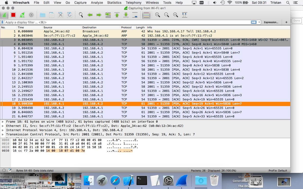

Nice! How did you see the packets if you don't mind me asking? I've never managed to figure out wireshark.
I'm interested since it might help me to get the Roomba 980 working locally.
Re: Smarter Wifi iKettle 2 script for Domoticz
Posted: Sunday 07 August 2016 14:52
by trixwood
Since I did not know what I was doing, I tried many options...
In the end i configured the kettle to my local homenetwork like normal,
on my mac i plugged in a cable, cable connects to internet/homenetwork
then i put internet sharing on in the sharing settings, and the wifi becomes an access point... I connected my phone to my mac, and then it just worked,... i was very surprised :o :o
kettle <-> homenetwork <-> cable <-> macbook (wireshark,internet connection sharing) <-> wifi <-> phone
wireshark, if you open it, you select the connection (in this case wifi to capture the phone messages)... and then run the app on the phone...
ofcourse I accidently reset the wifi of the kettle, so now I have to try it again... :|
you should look for messages ending in 7e
screenshot from my own communication kettle <-> ibrew,...
Screen Shot 2016-08-06 at 09.31.32.jpg (185.25 KiB) Viewed 4010 times

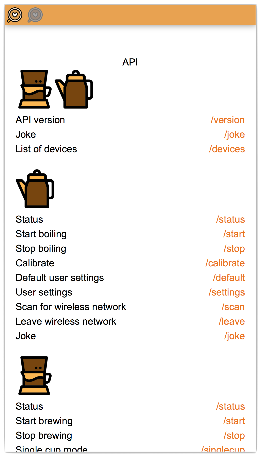

Note to myself, I will add more instructions when I finish the web part... kinda did not expect anybody else to use it ;-) :-) :-) Probably christmas depends how fast I recovery and can walk again... (yeah bummer for me, everything is on hold for me at the moment)
For binding it with domoticz you can use either the rest api (the part of the webstuff that is finished) or just script it using the command line options.
If you spend more then an hour getting it to work, stop. Post an issue on the github page, (since i get mail from that).
And please do not spend 11 hours ;-)
Signed me!
the rest api which returns json, docs are in the web part (old screeshot):
