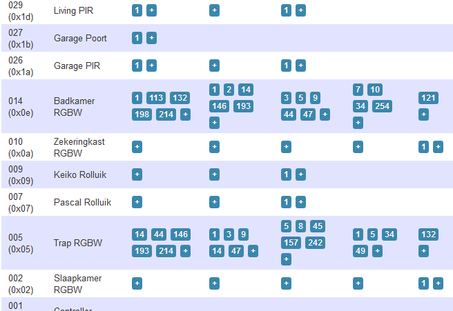

5 days later one of the RGBW dimmers shows multiple fake connections AGAIN ...
Is it normal that I must cleanup this table EVERY WEEK ?!!!
what am I doing wrong ????

just only 1 week later ... AGAIN the problem comes back ...
look : again on a RGBW dimmer (fibaro) ... never on a motion sensor (I have 8), never on a roller shutter (I have 2) ... ONLY on RGBW dimmers
is there some setting on these dimmers that causes this problem ?
Please help, this drives me crazy ...

Again there they are, the ghost connections on some of my dimmers ...
again, ONLY on dimmers, never on sensors or other devices ...
Is this a Domoticz-, a Zwave-, a Fibaro- or an Aeon-problem ?
How can I finally solve this, it's driving me crazy ...
Anybody ???
Anybody ???

almost 2 years later ... I'm still cleaning up phantom Zwave connections every 2 weeks or so ...
still no solution for this VERY annoying problem ?

And you are not alone, I have this behavior with Fibaro RGBW dimmers too with Domoticz for years now.pascalspits wrote: Friday 17 August 2018 10:53 almost 2 years later ... I'm still cleaning up phantom Zwave connections every 2 weeks or so ...
But not with my other domotica server that runs Homeseer so it must be something with Domoticz.
When will this be solved because Domoticz make the zwave network unstable. It must be something with the Fibaro RGBW support in Domoticz. When I turn Domoticz off it all runs fine and stable with Homeseer only. All other Fibaro modules are running fine in Domoticz without ghost associations.
