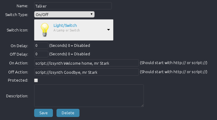

hm...bug found!
I just reboot my raspberry and appeared that no voice prompt can be reproduced from domoticz.
When I run command from shell is working. After creating the file manualy from console, domoticz also plays it. I suppose has to do with previliges. Any fix for this?
Error: Error executing script command (/home/pi/domoticz/scripts/izsynth). returned: 256
..."]:27: attempt to index global 'devicechanged' (a nil value)string "--
Re: izSynth: make domoticz talk with many TTS engines in a easy way
Posted: Wednesday 04 May 2016 11:36
by toreandre
korniza wrote:hm...bug found!
What happens to the "returned: 256" error if you put " & " after the on/off action in domoticz?
About the nil value error, isnt that a lua specific error?
If I use "&" at the end of on/off Action, issue not resolved.
I also checked /dev/shm folder after reboot raspberry and triggering voice prompt from domoticz. No sound output from speakers. here are the files:
drwxr-x--- 2 root root 60 May 4 12:41 izsynth-20160504-124120
drwxr-x--- 2 root root 60 May 4 12:41 izsynth-20160504-124154
Running from console the same command (example: izsynth -e voicerss -v en-gb -t "Panic Button Triggered! Please stay calm while emergency process initiating. " ) I get a sound output from speakers and there are extra files on /dev/shm.
-rw-r--r-- 1 pi pi 624522 May 4 12:45 Panic_Button_Triggered__Please_stay_calm_while_emergency_process_initiating__.wav
-rw-r--r-- 1 pi pi 239754 May 4 12:44 Welcome_home.wav
So the issue is that using domoticz does not create wav files. Hope it helps for debugging.

korniza wrote: Running from console the same command (example: izsynth -e voicerss -v en-gb -t "Panic Button Triggered! Please stay calm while emergency process initiating. " ) I get a sound output from speakers and there are extra files on /dev/shm.
mmmm.... I must try to reboot my rpi to see if that problem happen to me too... anyway, in your text I see a problematic character: "!"
You have that problem with all izsynth buttons? can you make a new button with a simple:
script://izsynth test
I think that we need gizmocuz to solve that problem.
Kind regards
Posted: Wednesday 04 May 2016 23:57
by korniza
Kind regards
I test this simple button and also I get the same issue
2016-05-05 00:52:09.587 (Synth) Light/Switch (test)
2016-05-05 00:52:09.915 Executing script: /home/pi/domoticz/scripts/izsynth
2016-05-05 00:52:13.143 Error: Error executing script command (/home/pi/domoticz/scripts/izsynth). returned: 256
and checking the files
~/domoticz $ sudo ls -l /dev/shm/izsynth-20160505-005210/
total 4
-rw-r----- 1 root root 5 May 5 00:52 test.txt
there is only the txt file but not the wav file. :|
Posted: Thursday 05 May 2016 21:23
by jin
korniza wrote:
jin wrote:This is a domoticz bug, please post a bug report.
Can you confirm that issue can be reproduced also to your system? anyone other can perform the test and trigger voice button after restarting raspberry?
pi@domoticzpi ~/domoticz/scripts $ uptime
 21:12:30 up 95 days,  1:41,  1 user,  load average: 0,25, 0,09, 0,07
sigh ;( pity for my uptime :)
rebooted and izsynth recreated without problems the recordings when pressing the button.
this is my screenshot:
2016-05-05 21:16:48.900 User: Admin initiated a switch command
2016-05-05 21:16:48.901 (Virtual) Light/Switch (Talker)
2016-05-05 21:16:49.398 Executing script: /home/pi/domoticz/scripts/izsynth
2016-05-05 21:16:52.964 User: Admin initiated a switch command
2016-05-05 21:16:52.966 (Virtual) Light/Switch (Talker)
2016-05-05 21:16:53.903 Executing script: /home/pi/domoticz/scripts/izsynth
I don't know because you get return code 256

mmmm.... your config is right...
I tested creating a "Virtual Button" of type "Selector Switch" (..) but the script works perfectly and I can hear the voice when I activate the button...
can you try putting the full path of the script? like:
script:///home/osmc/domoticz/scripts/izsynth test
I reinstalled IzSynth with Naturalreaders instead of VoiceRSS and it works like a charm now. Thanks for your help!!
